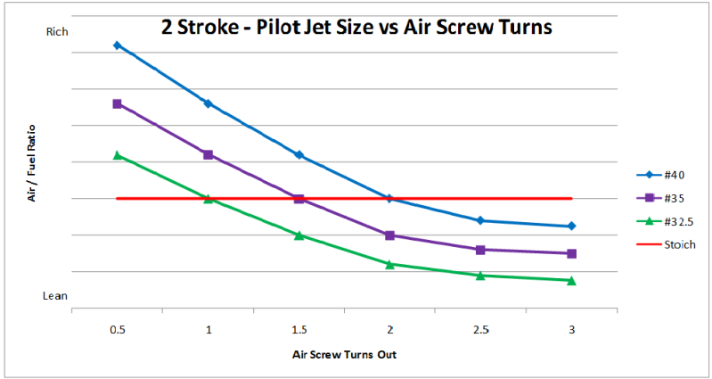

Here is a little something my brother put together as a "get the picture" graph.
The 1st graph shows a 2 stroke pilot circuit and how the various jet sizes for a Mikuni carb (stock blaster) correlates with the turns of the air screw and how it all effects air/fuel mixture
the red line stoiche (equilibrium) indicates the point at which the mixture is the same but with different pilot jets at different settings. In other words, a 32.5 stock pilot jet set at 1 turn out can run exactly the same IN THEORY as a 40 pilot at 2 turns out. HOWEVER, PLEASE NOTE this is not based on actual tests and is just a illustration of how the system works. it is not likely that a 40 will yield the same results at 2 turns as a 32.5 at 1 turn. more like 4 turns out which is impossible so its just a "not to scale" illustration.
So turning in the screw RICHENS the mix. turning it out LEANS the mix

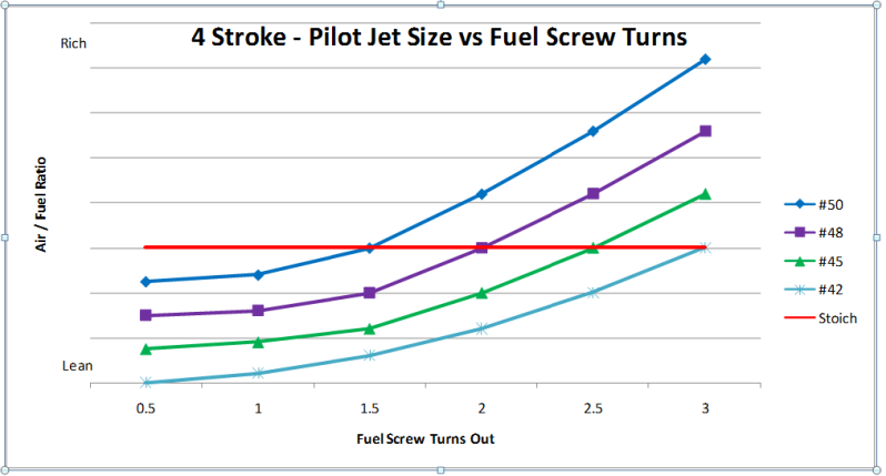

Here is the 4 stroke version!
Note that a 2 stroke and a 4 stroke work opposite to each other. a 4 stroke uses a FUEL screw while a 2 stroke uses a AIR screw!
otherwise the same principle applies. BUT
So turning in the screw LEANS the mix. turning it out RICHENS the mix.
Hope this helps someone understand better!
