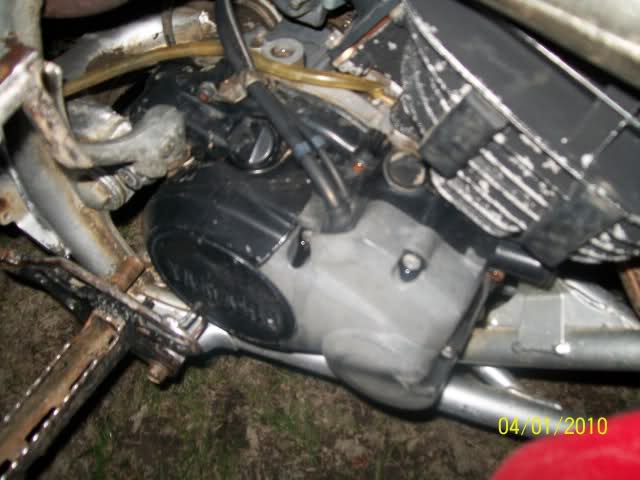

the only clear hose any of mine have is the trans oil vent hose, it should run across and up the shifter side to under the hood, but could have been changed on yours, it should enter the center of the cases in behind the oil fill cap,
the injection hoses should come out of the upper oil pump cover right in front of the clutch cover, look for them to be cut off there or some silicon where they blocked off the hole

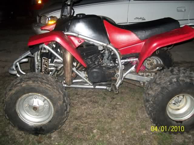

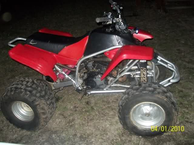

Here are some pics.
More to come. I will post more in the photo thread. Thanks for your help everyone.
Welcome to the site.
Bike looks good, these quads are alot of fun and very rewarding to work on, and keep them running the way they should. As for the 2 stroke oil, I cannot agree with AWK more. Why run outboard shelf motor when there are other, higher quality synthetics that will just plain lube better and extend life of the top end, period. As recommended, pick one and roll with it...
The stock heel guards have been removed from your bike, along with the plastic bottoms of the fender that mount to these heel guards. This can be deceiving as to make the bike look longer, but it looks like the swingarm is of stock length. As for the rear axle, just pull the wheels and measure from tip to tip, 33" is stock blaster and the banshee axle will measure about 36.5", have at it...
Your rear shock spring is red, which is not common. What is common when a red rear shock is seen on a blaster is when the bike has been retrofitted with a Honda 400EX rear shock, which is a substantial upgrade over the stock blasty shock. Check under your rear fender at the top of the shock, is there a large round ressi/canister connected? If so, bravo, that is a great upgrade already done. If not, disregard the babble above, and plan to perform this upgrade at some point. It is inexpensive and quite easy to install... :D
Also noticed your rear brake lever is missing by your right foot peg??? Is the entire rear brake setup removed? The pre 2003 blasters do not have the greatest breaks, all mechanical, drums in the front, mech. disk in rear, etc. 2003 and up were fitted with a fully upgraded hydraulic system, front and back, much better. These brakes can be fitted to the 2002 and older but there are so many other options as well, again affordable and semi easy to fit, if you have the right resources available. (See AWK's rear GSXR1000 fab, very impressive)
Just a few things to pick your brain about. Feel free to start new threads in the appropriate Site sections based on some of these topics if you want to get into detail, or simply respond with general info if you want to, in this thread.
It is YOUR thread, right???? I:I

The shocks are really pink. All three are pink. The picture was taken at night so it does indeed look red. I am going to go with the 400 EX shock since my brother in law has one he is selling for $20. I am actually buying all three shocks from him for that but understand the fronts don't match up. So I will put them on Craig's List or Ebay and maybe get my $20 back. lol.
