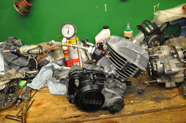

got the engine all together, doing the leakdown, its leaking bad between the intake boot and the vforce reedblock.
gonna throw some sealer on it ima guessin.
cant decide on using the yamabond stuff or permatex copper
any suggestions?
Alrighty then. got the engine together and finally a chance to do the leak down
test today, only after a brake job on a customers car.
got it to hold that 7 lbs only after much hair pulling out. first the intake boot was leaking in between the boot and the vforce 3 reedblock. had to seal it all with permatex copper.
then it was still leaking, so, off came the flywheel first as it is the easiest to pull, and sure as hell, the seal is blowin bubbles like a 5 yr old on a hot summer day, i pull it out, and, what do you know, my buddy vito hooked me up with some fine made in china crap seal!!
this pissed me off, cuz it wasted alot of my time, but THANK god i did the test! the inner seal has a blantant defect, and now im very glad i have a yamaha seal on the clutch side.

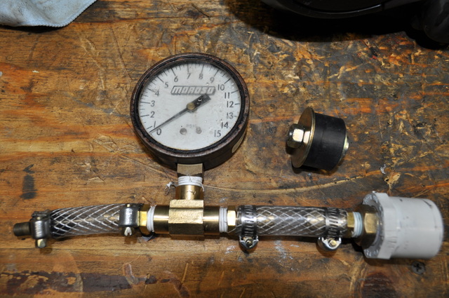

here is the leak down tester i put together. i had the moroso gauge, it came off this low pressure tire gauge i have from my drag racing days. a few parts from lowes and a expandable freeze out plug from pep boys and i was set
i used 1/4" barbs and T. the piece for the carb boot is a 1" plumbing reducer. had a hard time getting it to seal in the carb boot, finaly coated it with yamabond, let it set up then put it in, worked like a charm, pulled it out, just peeled off the yamabond.
taking the time to make this tester just saved me from a definite leaned out condition. i would have smoked a new engine, and i dont think i would have been happy.
