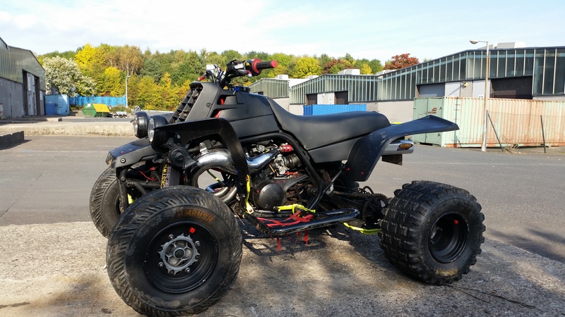

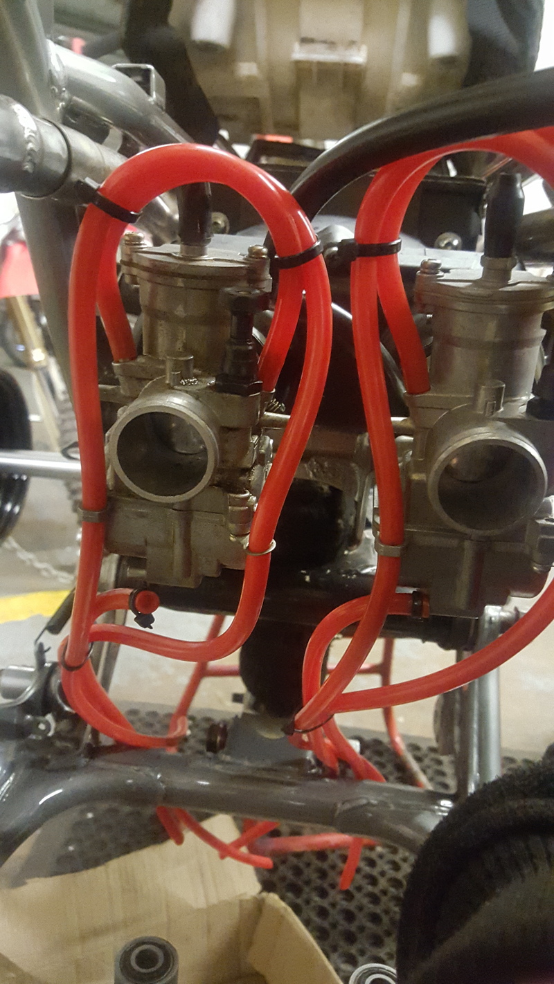

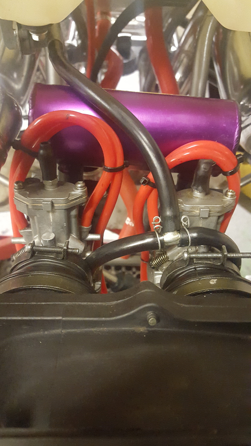

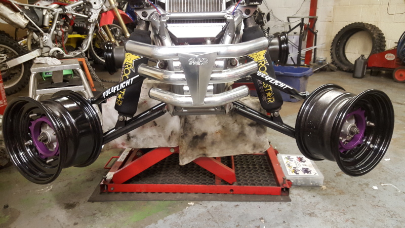

Picked up a road registered banshee 350 in rough condition, rattle can painted plastics, frame & all sorts. Powdercoated fluo yellow parts all over it. Vile looking thing.
Ran well, blew plugs on the left hand side every 3 hours. Nightmare, i like a good project so stripped her down for my own personal touch.

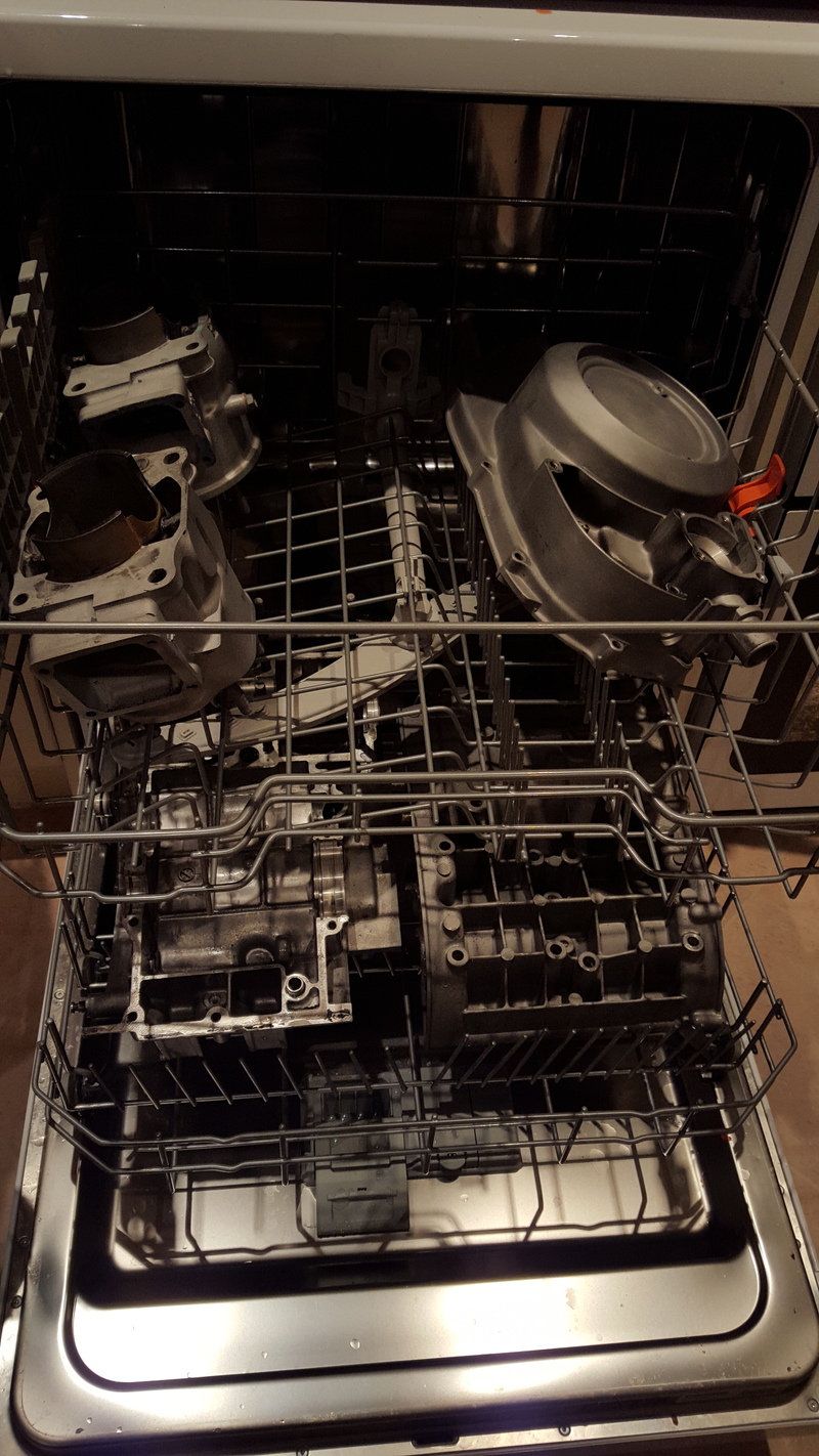

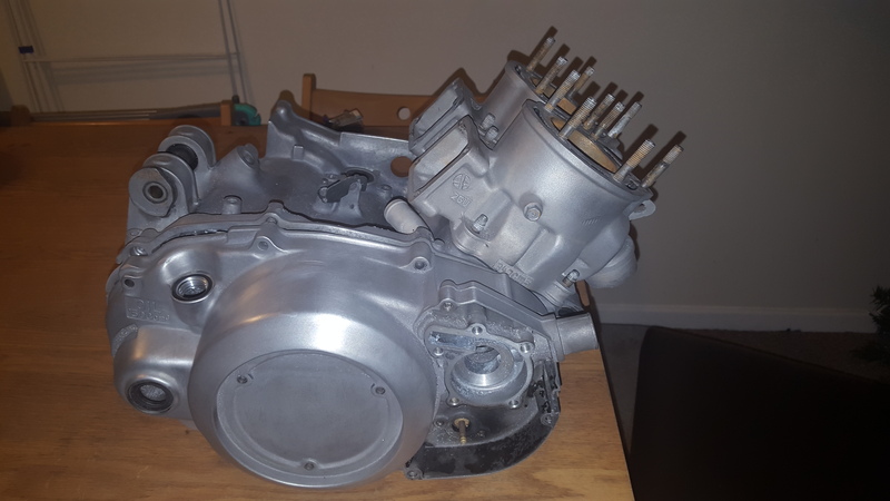

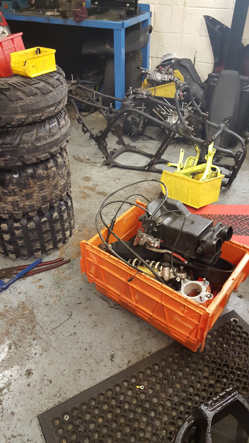

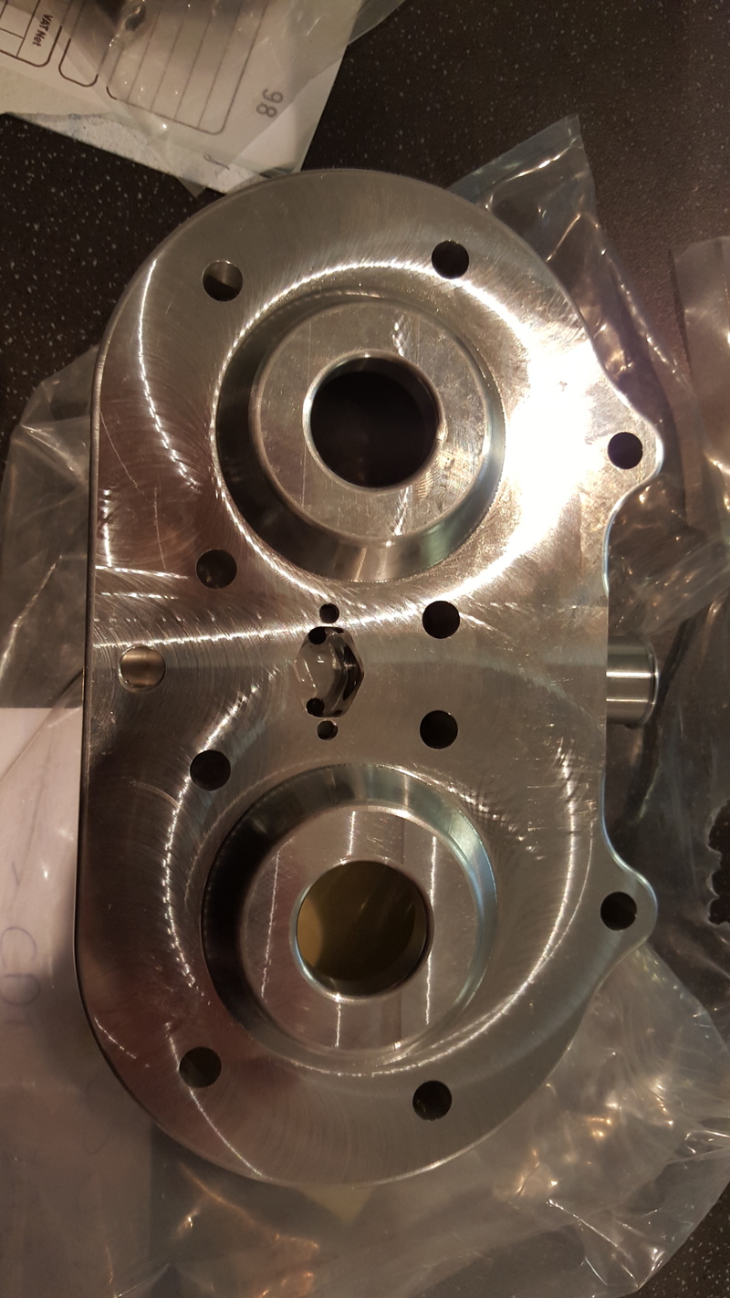

Stripped the motor down, blasted the cases & cylinders.

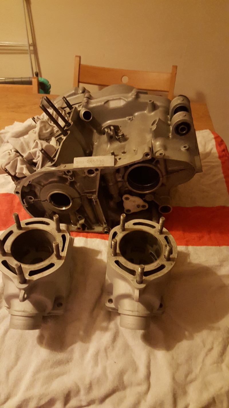

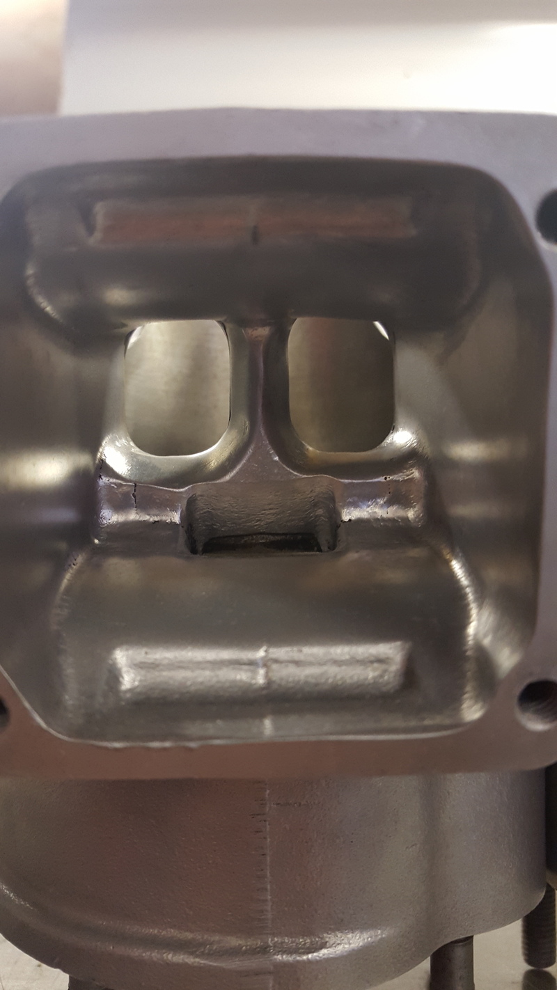

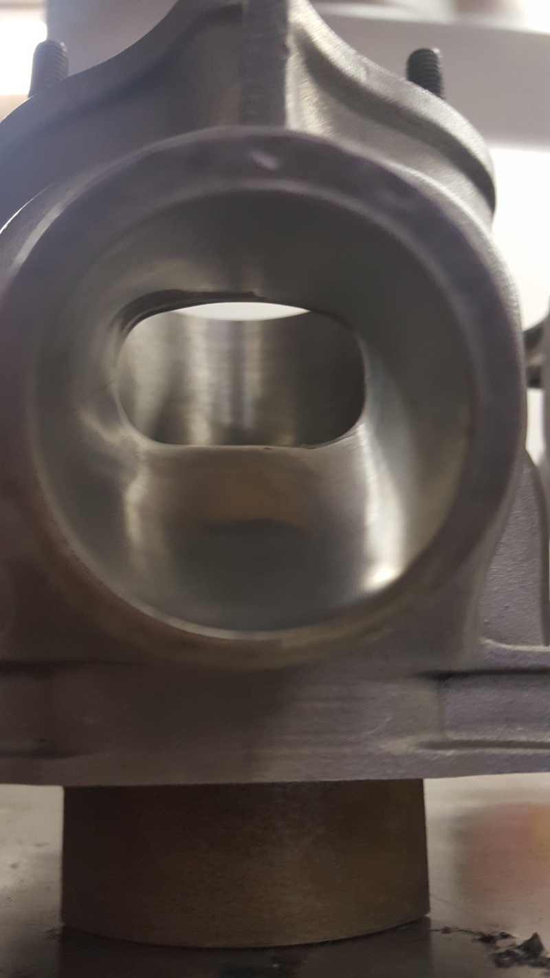

While stripped, ported & polished the cylinders, over bored 2mm to 66mm, cases currently undergoing work so no pics of those.

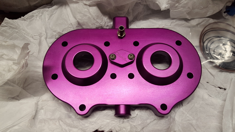

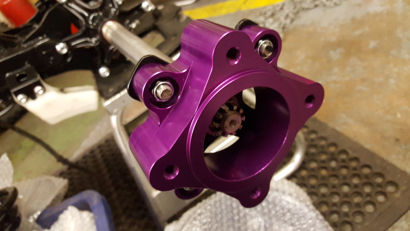

Got a Chariot performance coolhead, got that anodized along with my wheel spacers & rear brake block off.

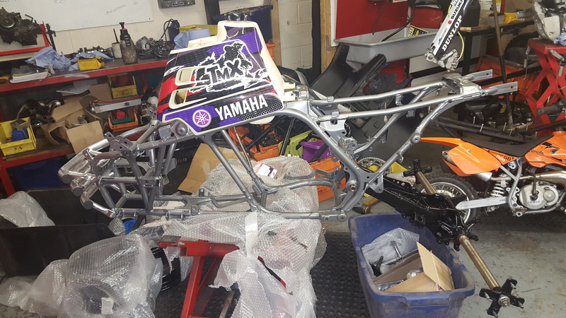

Frame etc went off for powdercoat, all new bearings throughout.
Will post more little later....
