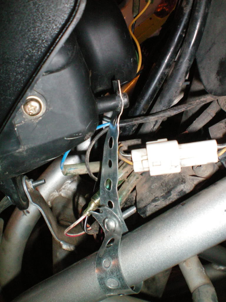

No don't buy a mount use plumbers strap I took a drill bit the size that I needed to fit over the headlight pegs and then wrapped over the frame and it holds so perfect it doesn't even move. The hood fits perfect over it just when your done you have to pound the bottom of it up other wise you will have to cut you fenders; then after you do that you just have to reajust so it snugs up the headlight. Then it took a sheet metal fastener and put the screw through that and a washer to make it so the screw would go through the hole in the plumbers strap. My last and final step was to cut off all axcess plumbers strap with tin snips. Here is a pic. so you can see exactly what I did if you need any more pics. of the tools I used or the material just let me know and I will be more then happy to send you them:
[/IMG]
