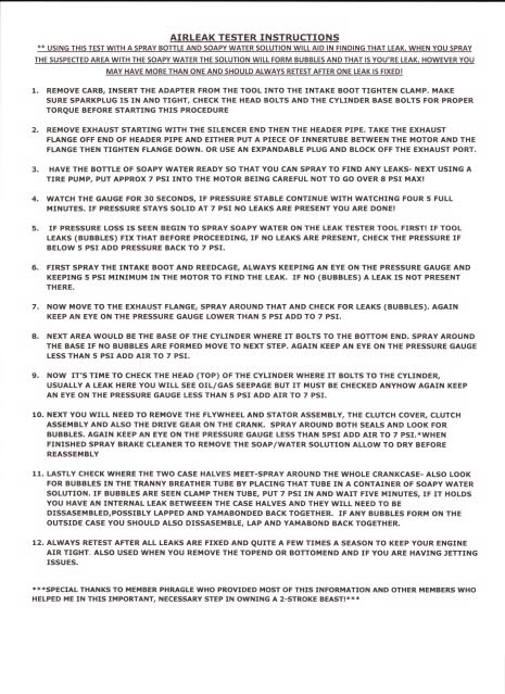

haven't had much time to work on the bike but the reeds aren't damaged I looked at them. and it holds 128psi consecutively. I thought a leak down was for when you can't hold compression?
you use A leak down when you rebuild your motor and then a problem comes up it is usualy the first thing to do
You've confused leak-down with compression. Either/or could be good and other not. L/D tests seals and gaskets for ability to not let air IN. Basically engine is pressureized to 7psi and should hold for at least 7 minutes with very little loss. Never excede 7psi.
It is all in a word.
A leak down test is the phrase for a test commonly performed on (wash my mouth out with caustic soda) 4 strokes.
It is used to diagnose wether lack of compression is due to leakage down past the rings or from the valves.
A leak test is performed on a 2 stroke to ascertain that the engine is leak free from the carby inlet to the exhaust outlet.
It tests the whole engine, gaskets and seals.
A leak test is very important as any air leaks in a 2 stroke can cause a catastrophic lean mix.
When folks on a site dedicated to 2 strokes use the terminology "leak down test" they really mean "leak test".
