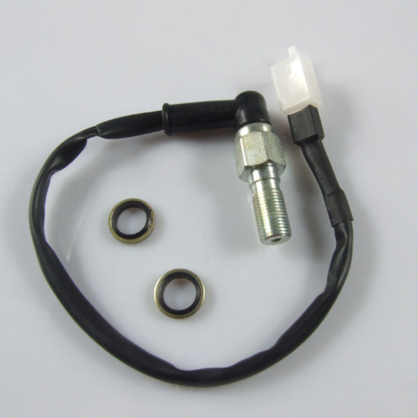

or, you can get micro switch banjo bolts and wire thru them.........
http://www.ebay.com/itm/Motorcycle-...Parts_Accessories&hash=item4d18dbd36e&vxp=mtr
be sure to get the correct thread/pitch for whatever master cylinder you use/have
