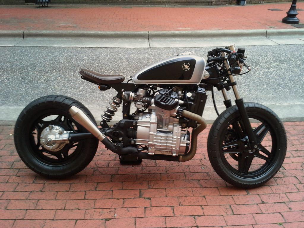

for now, here's what I'm aiming for.... a stripped down, bare bones, cut off subframe w/ single seat, mono shock conversion, tough looking dual sport tires, short offset bars (not clip-ons), minimal fenders, and reworked possibly 2 into 1 exhaust.
I'd also like to do a disc brake on the rear, but I don't see any others doing it ?
I'll be looking hard into it.
something like these.........
