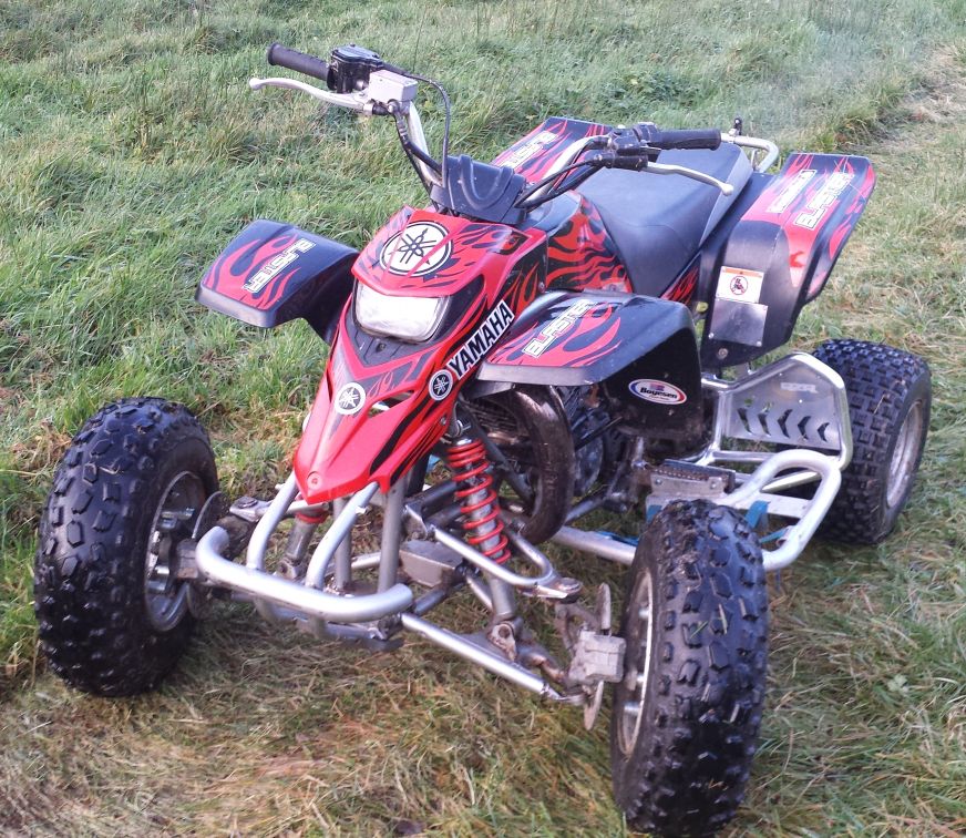

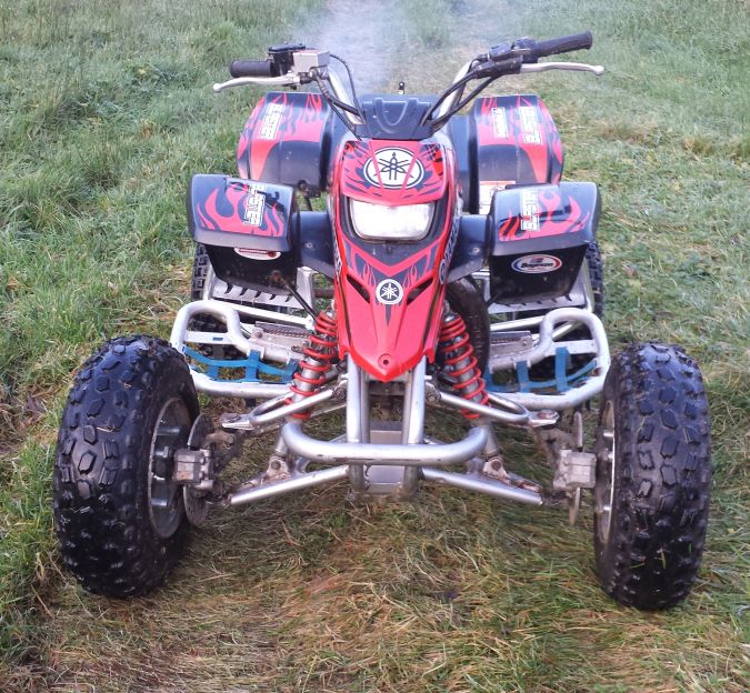

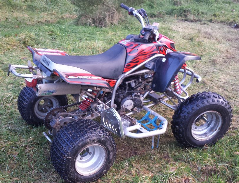

Before fitting the DMC Alien.
Year | Make | Model :
1. 2006
2. YFS 200
3. Blaster
A Arms: Stock, with Diamond J 6inch widening and lowering kit.
swingarm: Stock.
Steering Stem: Stock.
Stabilizer: ??? 7 position
Axle : Banshee
Carrier: Stock.
Locknut: Stock.
Hubs F|R: Stock.
2 1/2" stud spacers all round.
Bars: Stock.
Throttle/Clutch Lever: Twister/Stock.
Grips: Stock.
Nerfs: Chinaman modified
Bumper: Stock.
Grab Bar: Stock.
Front Shocks: Dual rate YFZ450 Works
Rear Shock: Stock, with lowering thingy.
Brake Lines: Stock.
Rotors F|R: Stock.
Rims F|R: Stock.
Tires F|R: Kenda Klaw.
Body: Stock.
Frame: Stock.
Plastic: Stock, some removed.
Graphics|Seat Cover: Nil.
Number Backgrounds: Nil.
Handguards: Nil.
Bar Pad: Nil
Fuel Tank: Stock.
Engine|Drive System:
Cylinder|Head: W W Holden, 22cc Toroidial
Bore & Stroke: Stock.
Displacement: 195cc
Carburetor: 26mm Mukini, #320 main , needle on second lowest clip.
Air Filter|Box: Foam pod directly on carb throat.
Pipe|Silencer: DMC Alien
Clutch|Plates: Stock.
Gearing F|R: Stock.
CDI|Killswitch: Tether.
Cooling: Air.
Custom mods:...........Mild port and polish of exhaust port.
Pre mix ratio 25:1
2 stroke oil Castrol R30.

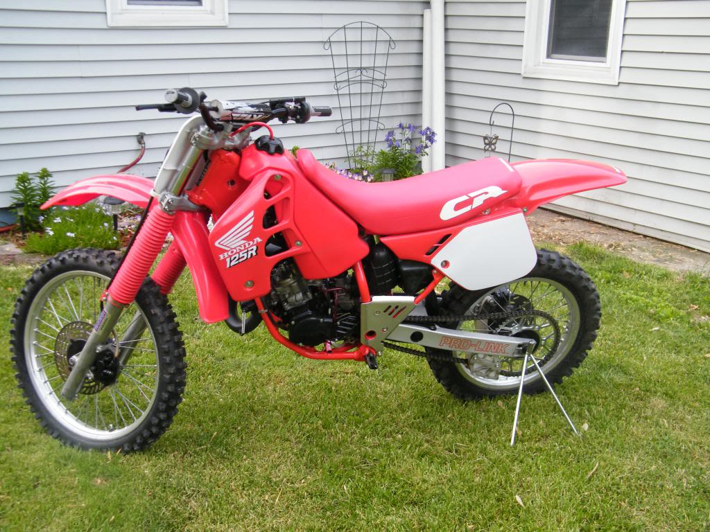

1.1989
2.Honda
3.CR125R
Forks: 43mm Showa conventional cartridge w/ 5w
swingarm: Stock
Steering Stem: +1 riser
Hubs F|R: stock
Bars: Fly midbend
Throttle/Clutch Lever: Motion pro
Grips: Pro Grip 801
Rear Shock: KYB (rebuilt,revalved,recharded for 160lb rider by works connection)
Brake Lines: New OEM
Rotors F|R: New OEM
Rims F|R: 21"stock/18"stock
Tires F|R: Dunlop/Dunlop
Body:
Frame: Fighting red custom powder coat
Plastic: OEM fighting red with HRC alum pro circuit stator cover
Graphics|Seat Cover: Oem honda
Number Backgrounds: HRC factory OEM
Handguards: none
Bar Pad: FLY
Fuel Tank: Stock 2 gallon/on off no res
Engine type: 2 Stroke, case reed, power valve
Cylinder|Head: Sleeved with wiseco/stock head (light port cleanup)
Bore & Stroke: stock 54 mm x 54 mm
Displacement: 124cc
Carburetor: Keihin PJ34
Air Filter|Box: UNI filter/stock box
Pipe|Silencer: Pro circuit (works)/Pro circuit factory 304
Clutch|Plates: Oem fibers/wiseco steel plates
Gearing F|R: 15 / 53
CDI|Killswitch: Stock/stock
Cooling: Liquid
Reeds:Boyesen
Custom Mods:
All custom color matched powder coating,forks/shocks reworked by works connection.
Wiseco steel clutch plates and vortex sprocket chain combo. Works connection frame guards where puchased from great britain as they could not be found to fit the 89 in the USA. All else new oem honda/hrc right down to the nuts and bolts.. About 400 hours of labor :)

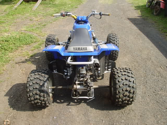

1. 2003
2. Yamaha
3. Blaster
A Arms: Stock
swingarm: Stock
Stabilizer: Stock
Axle : Stock
Carrier: Stock
Locknut: Stock
Hubs F|R: Stock
Bars: Stock
Throttle/Clutch Lever: Stock
Grips: Stock
Nerfs: Goldspeed
Bumper: Stock
Grab Bar: Stock
Front Shocks: Stock
Rear Shock: Stock
Brake Lines: Stock
Rotors F|R: Stock
Rims F|R: Stock
Tires F|R: Stock front/ 18-9.50-8 Rears
Body:
Frame: Stock
Plastic: Stock
Graphics|Seat Cover: Random Yamaha Flame Graphics /w Stock seat cover
Number Backgrounds: None
Handguards: None
Bar Pad: None
Fuel Tank: Stock
Cylinder|Head: Stock
Bore & Stroke: Bored but not sure on size
Displacement: Stock
Cam: Stock
Carburetor: Stock, #300 Main Jet
Air Filter|Box: Stock /w Air lid Removed
Gearing F|R: Stock
Cooling: Air
Custom mods:........... Mild Diy Porting, Boyeson Dual Stage Reeds, 32:1 Pre Mix,
2.5” Spacers All Round, QZR Heel Guards, Racing Ignition Coil, TORS Removed
