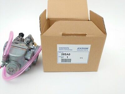

Yes, there is a good carb available as an upgrade for a stock to moderately modified Blaster. What you want to do is sh*t-can the Amazon carb and find a genuine Keihin PWK28 and an assortment of genuine Keihin jets. I've heard of some who managed to get a Chinese carb to work, and others who didn't. It's not worth the gamble to me, save yourself the hassle and pony up for the genuine article. For the pilot jet I would get #38 through about #45, and for the main I would get #138 through about #145. The sizes run in increments of two to three. Example: if you currently have a #142 main, the next size richer will be #145.
Be careful shopping, most of the regular reputable retailers of these carbs have been out of stock lately and eBay might be you only option in finding one. A lot of people peddling chinesium knock-offs and listing them as genuine Keihin. Searching for OEM carb for 85cc-100cc or so Japanese and KTM dirt bikes should help bird-dog some up for you. I got burned on a knock-off recently. They are getting very good at copying the real Keihins, shameless and a fair bit trickier to spot looking at pics. I sent it back.
Once you get a PWK, it will fit into the reedvalve intake boot no problem. But the air box boot will be much more stubborn. I managed to get mine stuffed into the air box boot by removing the boot from the air box, not fun but it allowed me to work with it easier and massage it over the carb intake bell.
As to hard starting, also check your reedvalve. Check for broken or chipped reed petals. This can also cause hard starting/no starting. Genuine V-Force 4 reedvalve is a good choice, that's what I got for my daughters Blaster. Be careful of knock-offs with the reedvalve too. I ended up getting mine from Rocky Mountain ATV after getting sent a knock-offs from eBay that was claimed to be genuine. Sent it back. It was priced a bit cheaper than RMATV, but not so cheap as to throw a red flag. It can't be overstated how unscrupulous these peddlers of knock-off parts are nowadays. Buy from reputable retailers whenever possible to avoid this nonsense.

THANK YOU for the info. I almost bought a Vito’s 28mm carb, but found a guy near me who sells blaster parts that had one OEM carb left…PSYCHED. So now, I have to do the trouble shooting. Any advice on jet kits would be appreciated!

Whichever option you choose as far as a carb, I would get a range of jets on hand for the pilot and main. If sticking with the OEM carb you'll need OEM Mikuni jets. I'm not as familiar with how Mikuni jet sizes run compared to Keihin, but I would get about three steps leaner and richer than stock for both pilot and main. There is really no set "jet kit" that will be the right combination for every machine in every circumstance. You'll want to jet your Blaster to whatever it calls for based on how it performs. There are some good pinned threads on jetting guidelines and how to go about it.
As I said before, Chinese carbs are hit and miss. Some report success with them, others not so much. I know Vito's sells a Chinese made copy of the Keihin PWKs and that's cool because they disclose what you are getting. I've just never felt it was worth rolling the dice and spent a little more on genuine Keihin carbs from reputable sellers and retailers. I've never had a bad experience with a Keihin PWK, from the little baby 28mm on my daughters Blaster, to the 38mm Airstryker on one of my 250R, to the 41.2mm PWK bored by Eddie Sanders on my big bore 250r. Great carbs and always respond predictable to jetting changes.
