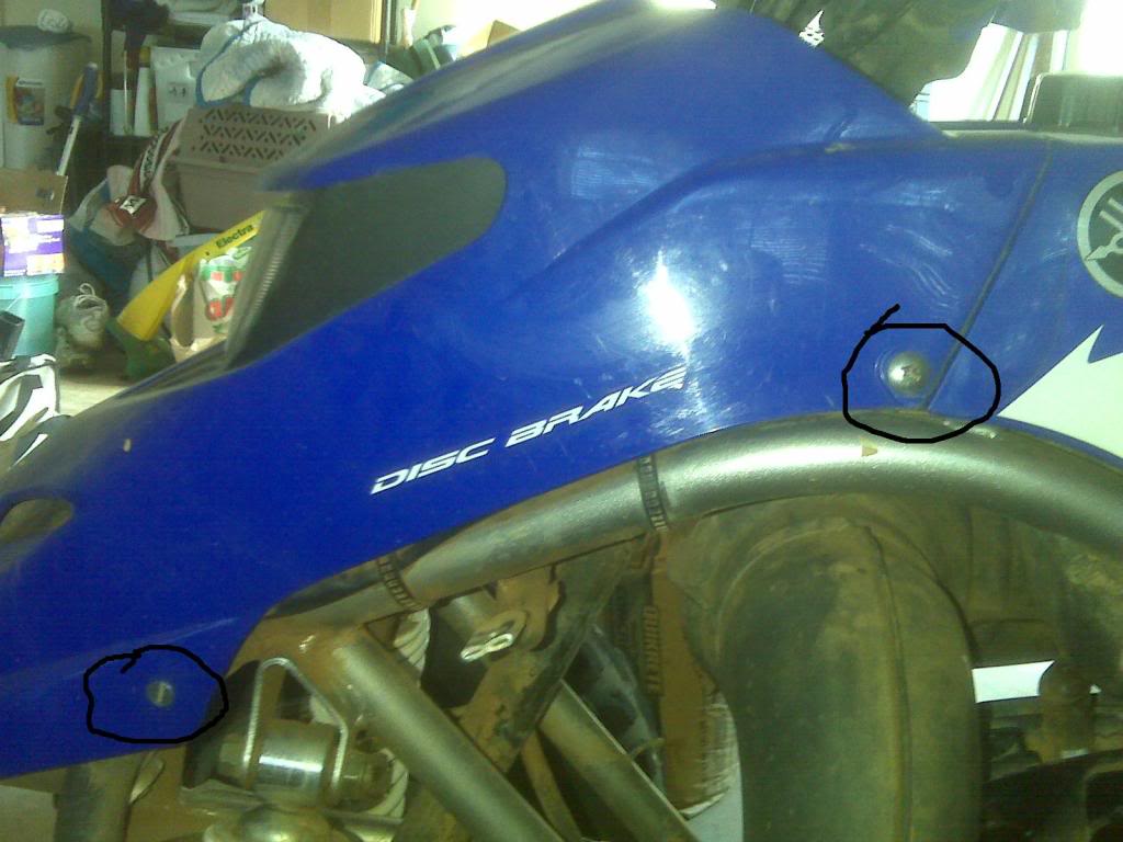

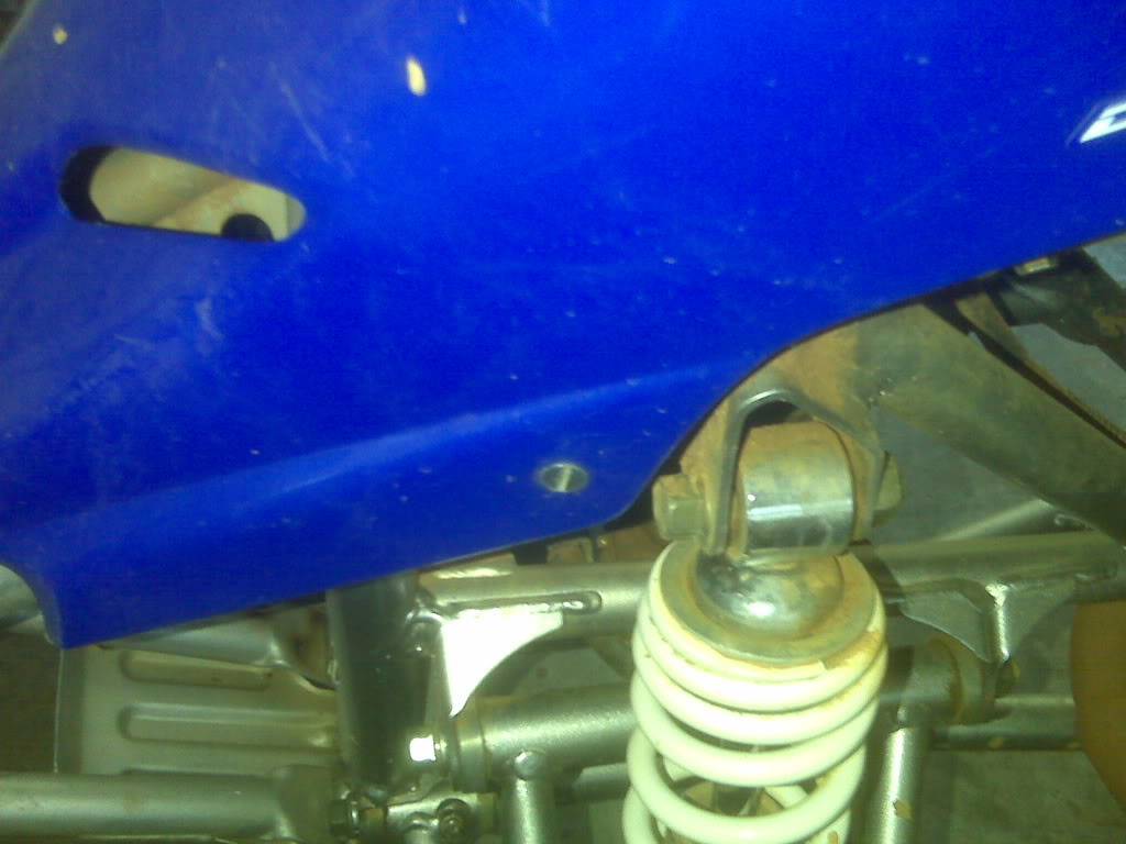

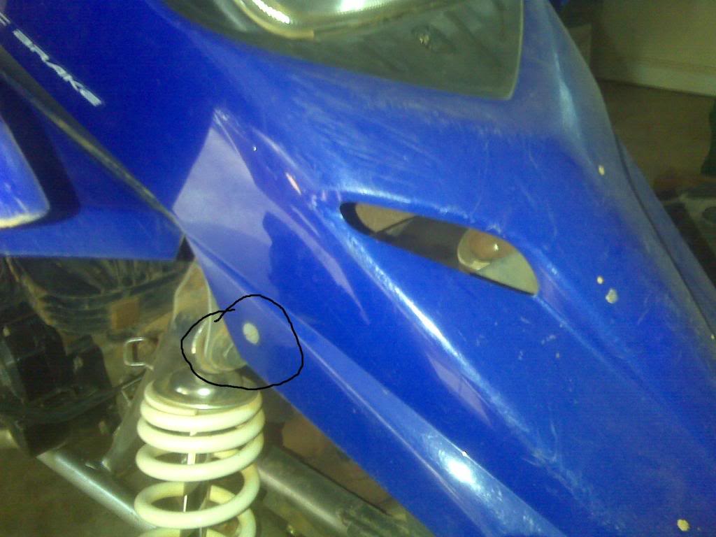

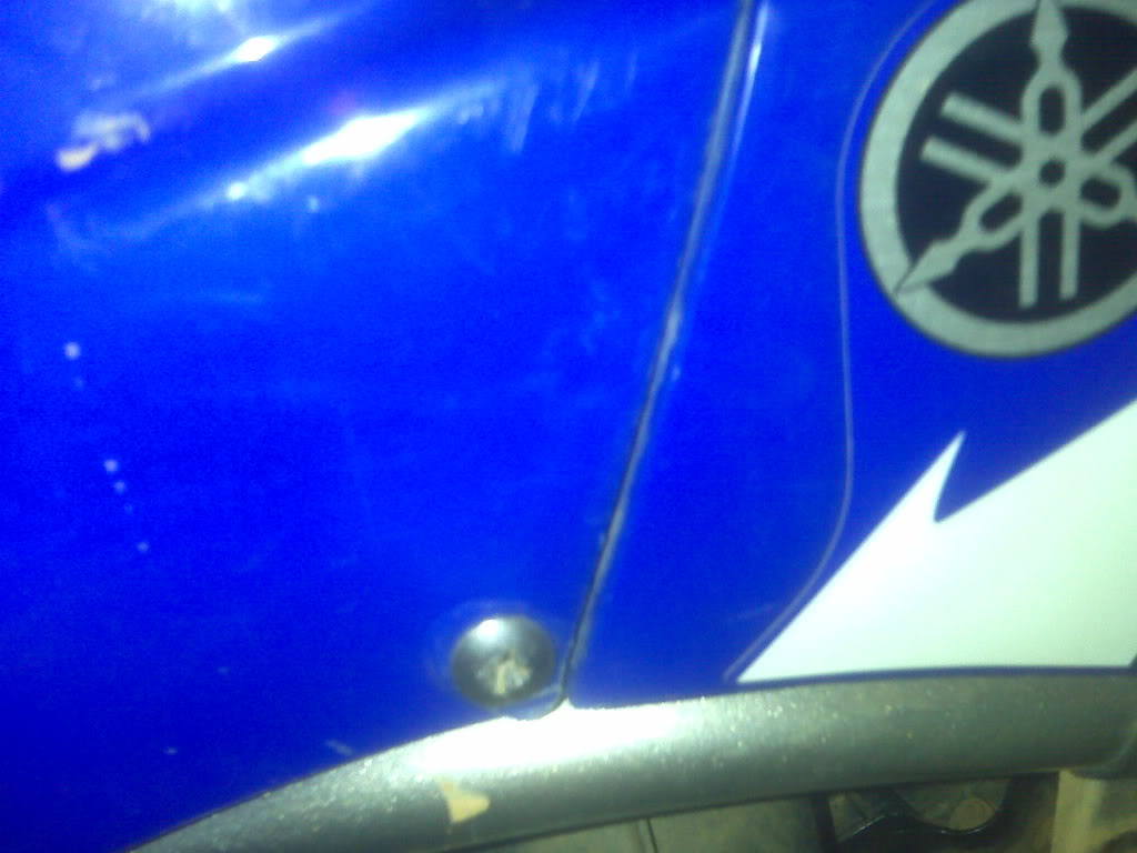

the bolt i circled in the picture is the only one that isnt "direct fit"
ok mate, sorry for all the questions, i just dont want to buy it and end up levain it cos it wont fit, when you say where the bolts fit? on my hood atm, there is 3 bolts holdin it, 1 on each side and one on the front, is that the same with the 04 hood, the side ones will be same but the front will be different? because 2 is enough i think/ hope u understood :)
the top ones ARE the same but the bottom ones are different. but you need all four because there are two at the top and two at the bottom, so if you dont use the bottom ones the hood will lift up and break when u go fast.
you need to drill out the two holes and use some self-tapping screws for the bottom ones
