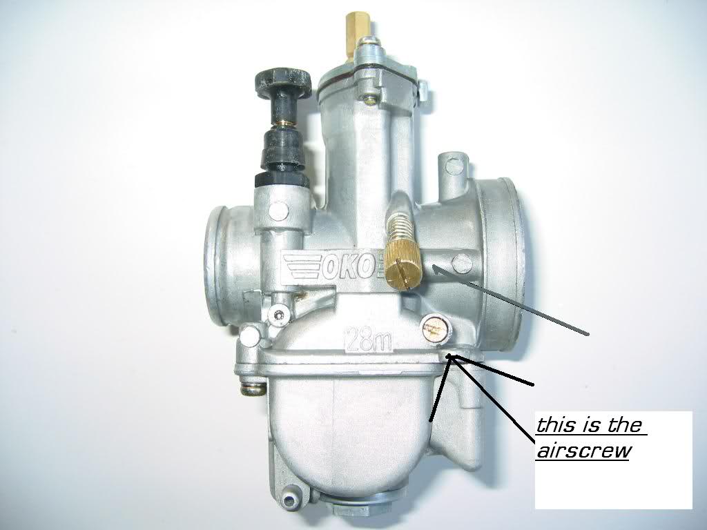

put a 270 jet and check your air fuel mixture screw this screw is out
