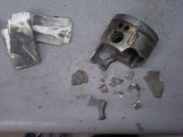

Here's some failed wiseco forged pistons... They're not "superman"...

Here's some pictures of failed pistons. Bothe forged and cast. I bet I could contribute the carnage to either ....
#1 improper jetting (too lean)
#2 Incorrect piston clearance
#3 DETONATION (too lean,too much spark advance,or both)
#4 wrong fuel to oil ratio (premix)
#5 Over heating combined with too lean of jetting
#6 High compression with poor quality fuel (DETONATION)
#7 or...a "combo plate" of more than one of the above.
Just set up either type piston properly, and do your part,and either will give good service.

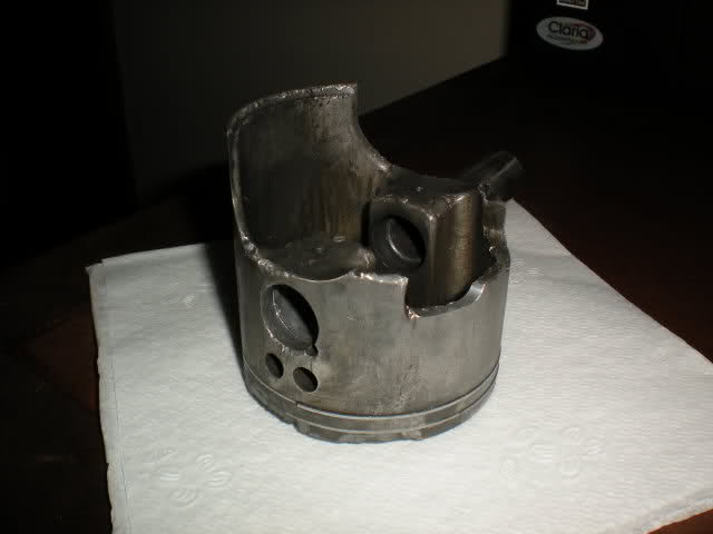

heres my 3 week old wiseco this is why you leak test
the motor got soo hot the wrist pin is siezed to the piston and will not come out
