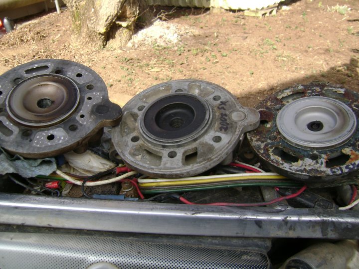

On the left, 7 years of mostly Ipone R 40:1.
In the center presumed cheap oils.
On the left 2 years and several thousand highway kms of mostly Ipone R, Ipone SELF2
and Shell Nautilus Premium Outboard Oil 50:1.
(I had gallons of it left over after I sold my PWC, outboard oils NOT recommended! Low temp tolerance)
Good oil is worth its price.
The bike from the center head had no compression and the powervalve was gummed shut. Made no power.
It was junked because of the problems from the poor oil.

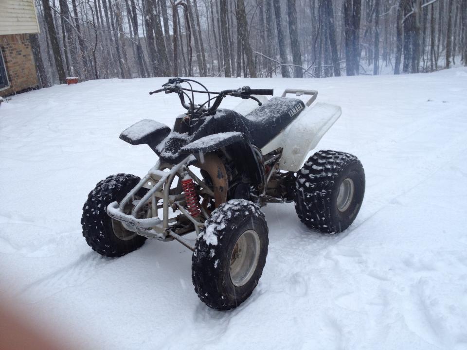

Alright guys. Ill be sure to use better oil haha. A lot of great info. And thanks Hillbilly Proud for letting me know. I was in shop rite and we were getting dog food and after that we were going to get some oil at autozone.. Funny cause the dog food is right next to the oil. My dad picked it up and just told me to leave. Got to ride today though, heres a pic
I have to get some good gloves for the cold. My dad has gloves he uses for riding his Harley but he doesn't really want me using those. And the snow I just put on some shop glasses and it seems fine.

Um, what about a helmet?
If you gotta $15 head you should at least have a $15 helmet on it.

Haha I kind of made it seem like I was only wearing glasses I:I
I have two helmets.. Both don't have visors so I've putting on a pair of glasses so the snow doesn't get in my eyes and bother my contacts.
