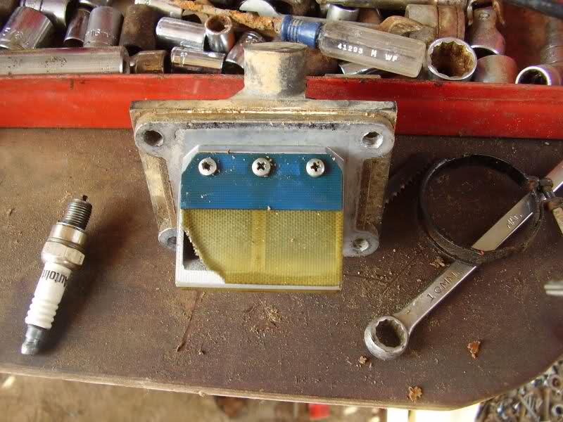

What kind of reeds fit my FMF cage?
no not all will fit. check how many holes you have on your cage. not 100%positive but i think fmf only. boyseen might fit also. just check your mounting holes and see how many there are.
I think boyeson reeds may fit my reed cage. It has the 3 bolt pattern like they do. I removed my reed cage and took a pic. What you guys think?
the ram valve is no better than stock ,they suck get a newer better design as they are cheap!
Talk to Cheryl at Boyesen. The Boyesen reed for the FMF cage are part #FMF001, which includes 2 reeds and 2 blue tensioners. BUT get this, They want $75 for a set.
