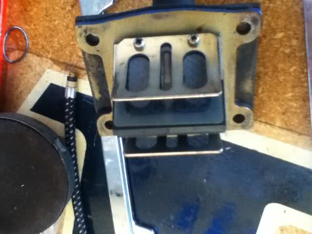

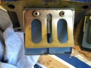

hi i have two blasters one was a parts quad and the other is my riding one and i noticed they both have two different types of reeds and wanna know what they are and what the difference is so i can run the better of the two in my quad thanks
this is the one from my parts quad
this is the one im using now
and both side by side
the ones with the stops are factory. the otheres look like boysen dual stage but worn out. you can take them off and flip them over to see if they will seat properly. you should use the metal reed stops too. that will prolong their life.
yeah take the boysens off and flip the pieces that aren't sitting flush. then take the big metal pieces off of the stock cage and put it on the boysens. als the little piece of metal that hold the boysens at the screws needs to be removed if you are using the reed stops. I know this can be a little confusing. I'll pm you my phone number if you have any questions
