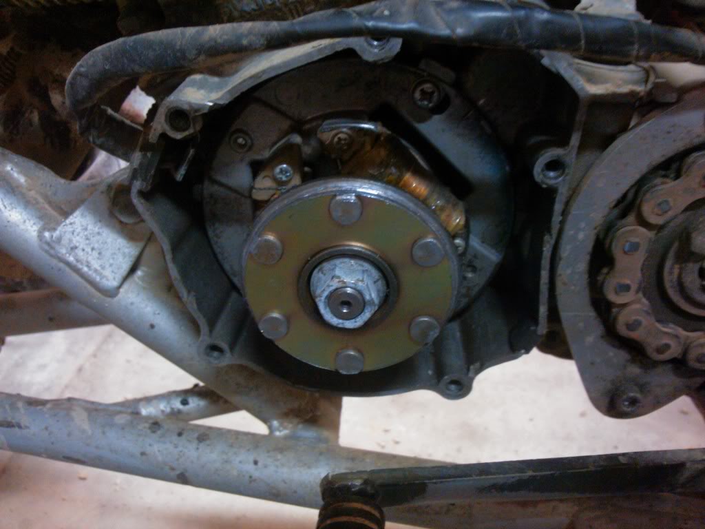

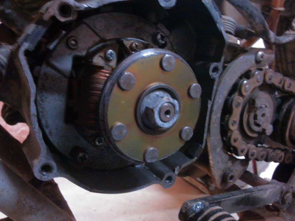

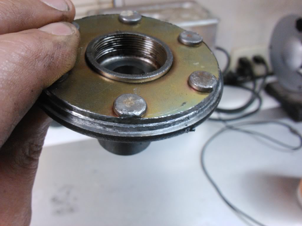

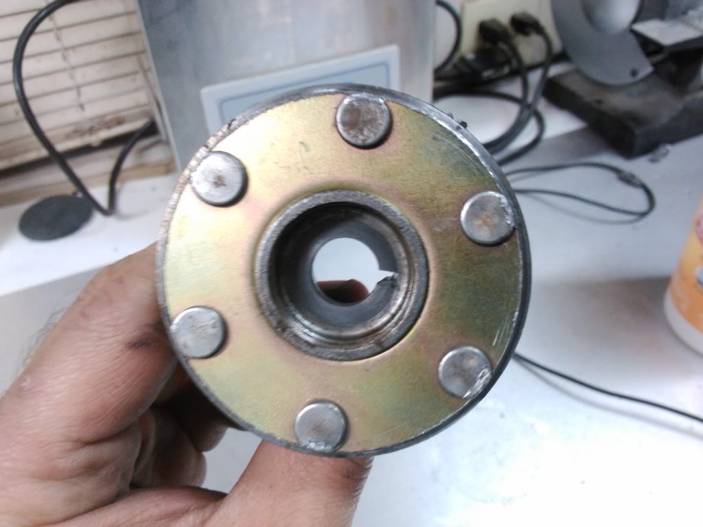

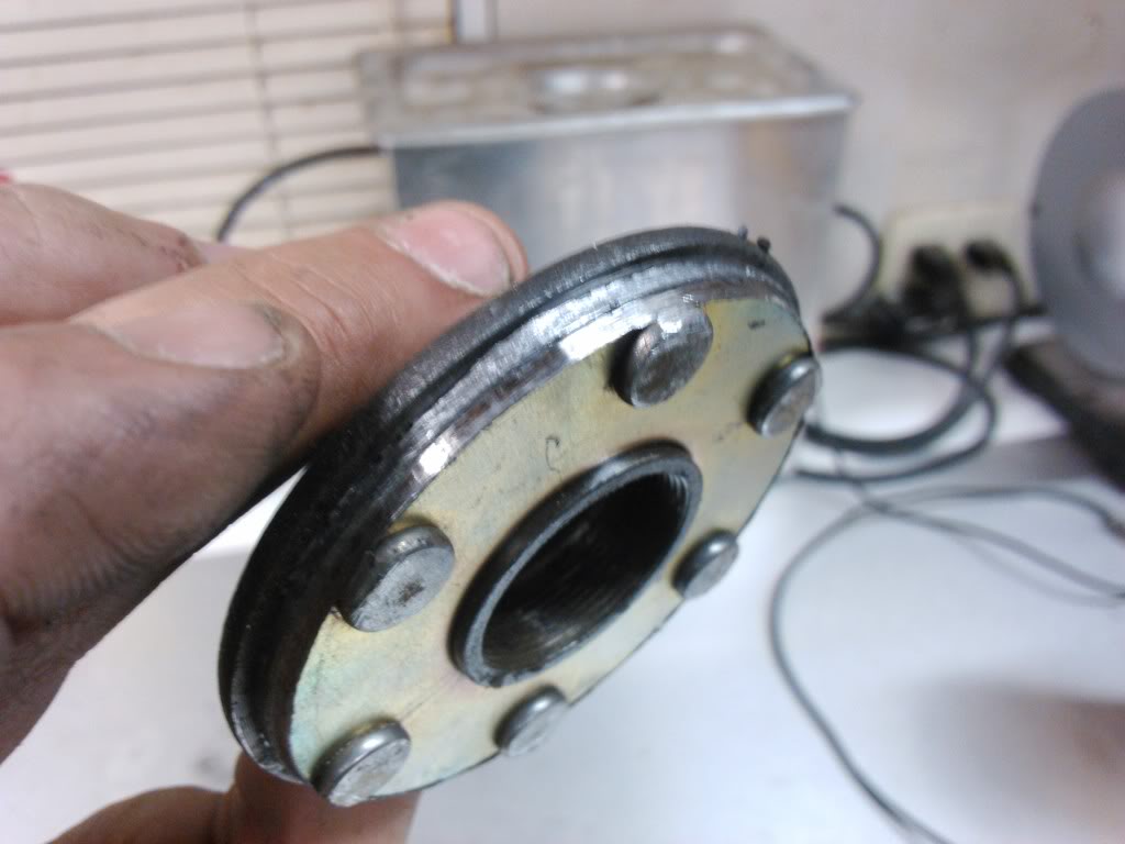

First and foremost KEN OCCONOR DID NOT LIGHTEN THIS FLYWHEEL. I had this flywheel lightened by a machinest we know. He took 20 thousandths off the side and face. This flywheel was torqued down to spec by ken when he assembled the motor. Not sure how it happend. I was ripping on it for about an hour and started to hear what sounded like detination. not sure if I was hearing things I decided to ride it a little more. It got louder so the bike was shut down. I tried to restart and it wouldnt. Pulled the plug and there was no spark. After going through all the wiring I pulled the stator cover off. I don't have a picture of the piece that broke off (Threw it in the woods), but you will get the idea. The only damage was the flywheel and pickup coil. Enjoy some carnage pics I:I

better send that local dude to the KOR youtube channel for a lesson in flywheel lightening, he obviously took too much off, and is why ken cut one in 1/2 to see just how far is safe to cut.......
You may be right. I will measure it in the morning with calipers and feeler guages. I think my KOR motor just makes to much power!
I don't think there is any cons. I think the machinest took to much out. if he did only take 20 thousanths out then there might be a risk of iy breaking loose. My motor has a lot of mods though. I've never heard of one breaking. Probably just took to much out.
After watching the video ken does it a little different. I will be sending him my replacement to lighten it. Lessen is it's cheaper to have KOR do it the first time, not the second.
Wow. Never seen any thing like that.. Definitely looks like little to much taken off. Thing is when do you draw the line,to much,,not enough?? Well as we all know the stock fly wheel is pretty thick to begin with and just leaving that little xtra while lightening would have probably prevented this problem.. by any chance did you feel any vibration,, as if a magnet came loose and it vibrated to self destruction or magnet got stuck on inside and it sheered off being so thin.... Kind of like a drag car spinning rims without bead locks.. seems like you got a pretty peppy motor..I:I
