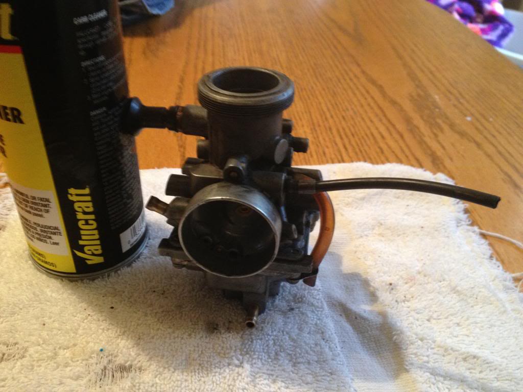

Before I clean the carb, did I do this right? Haha sorry for my lack of experience..
are you talking about that short black hose , that is your Oil injection inlet , do you premix the fuel and oil now ?
Edit : Also when you take the Bowl off , check your Main jet Nut under that piece of plastic and tell us the number !
Yeah the black hose. I was watching a video about the carb and he said it was a fuel injector. The guy told me to pre mix the fuel and oil, I was thinking that's why it might be disconnected.
Should I clean the entire carb or just the bowl?
That is the oil injection inlet , that inlet needs to be plugged off , otherwise it will suck in air , And anything else flying around , You need to check by the kick start side of motor , there is a cover with 4 bolts on it , that is where the Injection pump is , Need to check that !
you need to cap off that hose. i would remove it completely and use a vacuume cap to seal it off. you will suck air through that hole causing your blaster to run lean. also need to read the mainjet size let us know what it is and what mods that quad has. that way we can help you jet it properly
