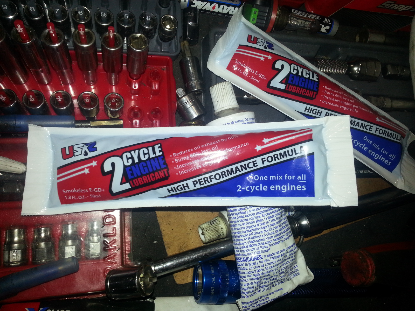

so i got this stuff from shop next to mine going to try it out when i get my quad back together says to mix one of these with a gallon of gas. any one else every seen these?:-/
Is it a lawn & garden shop by chance? The manufacturer of this stuff is recommending that you mix this at 70:1, this might be ok for a really small bore engine like a weed whacker but I wouldn't trust it on a Blaster. Maybe US2 knows something I don't, but this is probably just clever marketing on their part to sell their oil at $1+ an ounce. Stick with a respected oil at 32:1 mix and save yourself some headaches.
Haha no its a semi trailer repair shop lol I was surprised they it. Its one of them shop that has a lil bit of every thing ya know. I check out there web site they say it can be used in any 2 stroke engine but what im getting out of it is it has fuel stabilizer in(12 months). So what im thinking is you put in with your last tank of fuel of the season so that way it starts easyer in the spring or for that middle of winter ride lol
I use a Homelite oil in my weed whacker and blower that has sta-bil in it and I've never had problems with them. My power equipment that is worth more than $100 gets Sta-Bil or Sea Foam added to every tank. With the exception of my boat, I'll drain the fuel and replace it if it has been sitting more than a few months. I may be wasting some money out the tail pipe but I figure it is cheap insurance against fuel system problems and premature engine failure.
I have used sta-bil before worked alright. I have heard mixed reviews on sea foam thro gives your cars some problems lol. Just like if you buy gas and the sign at the pump says my contain up to 10% menthol you dont have to buy that gas line antifreeze crap( that comes in a yellow bottle 90% of the time). all it is is menthol

I sure hope that the manufacturer does not claim this, as using a fuel with oil added in a 4 stroke, without rejetting, is going to produce a lean mix, which may cause piston trauma caused by extra heat.

If you add oil oil to the fuel that you put in a 4 stroke you effectivly lean out the fuel/air mix, not a real smart thing to do.

IF that claim is legit, and the oil really has been tested to ISO L-EGD and/or JASO FD standards, it is of high enough quality that it won't hurt your engine if mixed to the proper ratio. AMSOIL, Red Armor, Powerblend, and other leading brands of air-cooled 2-cycle oils are tested to these standards, as a way to prove to the buying public that they are of good quality. That said, mixing any brand of oil at 70:1 is dangerous in a Blaster's engine. At least I won't do it on my bike. Too lean.
The fuel stabilizer claim is bogus. As a firefighter AND a mechanic who has to deal with screwed-up small engine fuel systems on a daily basis, there is no way a little thrown-in fuel stabilizer is going to make your fuel last for months on end. Without going on a long rant, suffice it to say that maintaining freshness is only part of the problem with storing today's poor-quality gasoline. Phase separation and water contamination are also of concern. Ethanol causes all kinds of fuel problems that no chemical additive will completely solve. A product called Ethanol Shield HELPS, but isn't a cure-all. Star-Brite's Star-Tron additive is also successful. Though you still need to use up all the gas within a couple months or you'll be asking for trouble.
Bottom line on the oil? I'd run it without worry in my 2-cycle power equipment, mixed 50:1. But I wouldn't trust it in my Blaster. Not when better-known and proven oils are readily-available.
