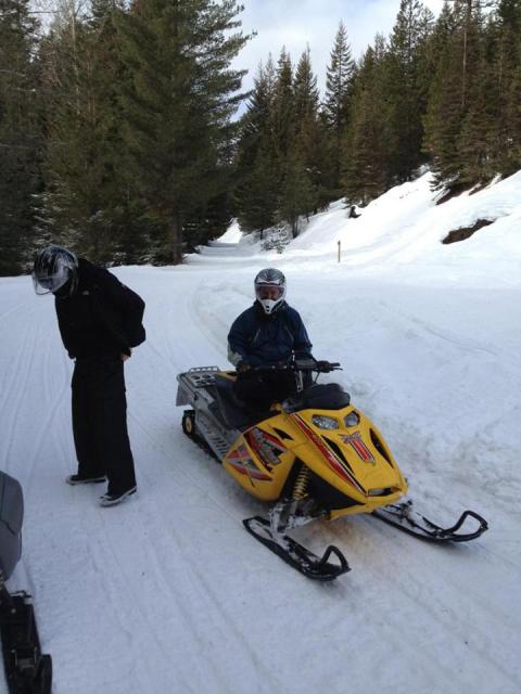

You can do either you just gotta pay for it, I know a guy who owns a sled rental place and this is the one I rented from him last year:
It's got a turbo kit and has well over 200 hp, the only problem is that the turbo kit alone cost as much as 5 or 6 Blasters

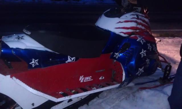

Here is a picture of his personal sled "Captain America":
It is a "4-Choke" 1200 cc turbo that has just shy of 400 horsepower
Fast is an understatement and I think he has 30 or 40 grand in it
