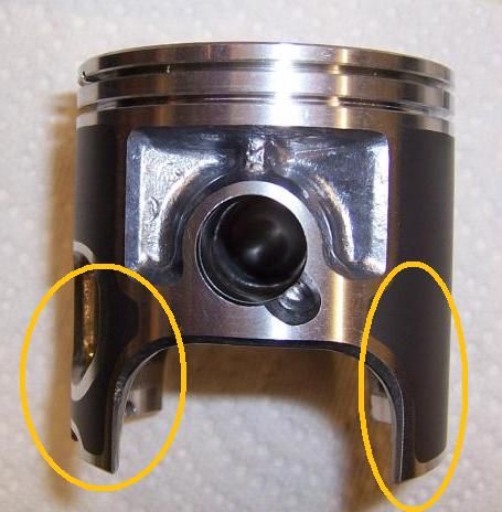

this is a new piston with both skirts intact.....
see the piston skirt broken off in these pics........
it's usually the exhaust side that breaks
