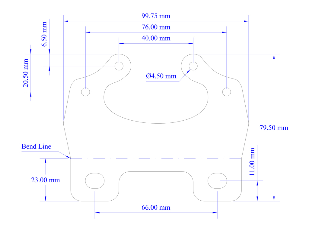

Hi all. Just drawn up y mounting plate for my Trail Tech Endurance II. Mount is made for the LSR clamp but most likely fit others. Making it out of 2.5mm thick aluminum.
PDF Download: http://www.4shared.com/file/Gl_BmoOece/Trail_Tech_Dash_Mount.html
DXF Download: http://www.4shared.com/office/p3Xr1U1oce/Trail_Tech_Dash_Mount.html
Made is so the LSR logo can still be seen.
This is the stock mount and is flat. throttle cable was very tight on it and rubbed. New mount will be bend and making the dash angle more to the rider.
Might help if some one wants to make there own.
I will upload a photo of it when its cut and another photo of it fitted.
