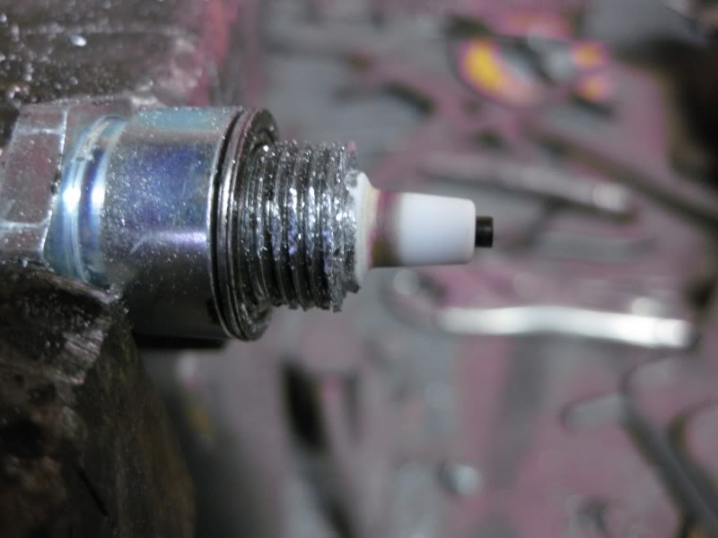

I would say its pretty darn close now. Maybe just a tad rich still. Here is a plug chop with the 270 main. Don't mind the redness, the cam was turning everything red tonight, even the grass. Must have been the lighting or my lack of camera skills.
300 is way way to big if your on the stock mikuni move the clip to the middle and try a 270. that should do it for you if its just piped. but you just need to mess with it. eventually you'll get it.
