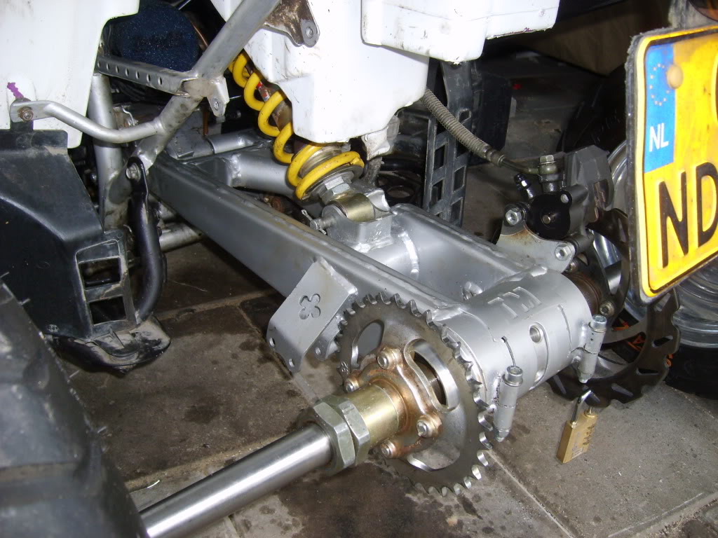

Kinda with what Luni said... I'd prefer no modification. So it looks like 14T is my biggest possible no-mod front sprocket. How about rear sprocket? How small can I go? Would a really small rear sprocket even need modifocation? And once I determine my smallest possible rear, where can I get it?
32 is too low in the rear unless you have some crazy power. That puts you at a top speed of 75mph. Most blasters dont have the power to pull 75mph.
For you, with a 240 kit if its ported, or even a stock jug with a +4 crank, it could make some sense. For most of us, that doesnt at all.
