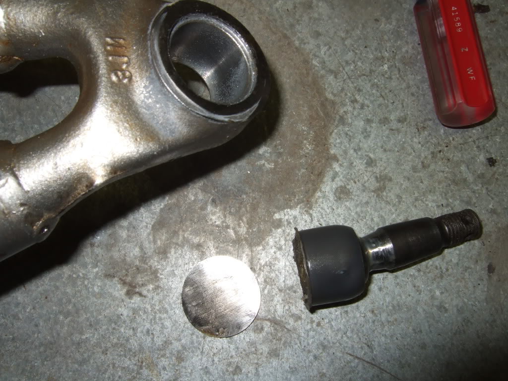

So a few weeks ago I picked up a set of raptor brakes for a great price and got to looking at options to fit them to my blaster. I looked around and found all of the other routes of doing this but thought of one I didnt see. Why cant I fit a tapered ball joint to the top of a stock blaster arm and run banshee spindles, hubs, and brakes. I found a set of used arms courtesy of Braaaptor195 for the sole purpose of destroying them to test my idea. I got some time tonight went to the shop and started playing around. My idea seemed simple enough take the lower tapered joint from the lower arm of the blaster and fit it into the upper arm. First up I had to find a way to remove the lower tapered joint without destroying it, the arm is sacrificial and would not be used so I just ground the top down revealing that there is just a formed lip holding a plate over the joint.
Then I was able to remove the joint itself which appears to be a steel ball with the taper and plastic molded around it while it was in the arm.
Now off to the upper joint removal was the same as the lower. To my pleasure the lower cup and upper cup of the joint is exactly the same so the lower joint just slid right in.

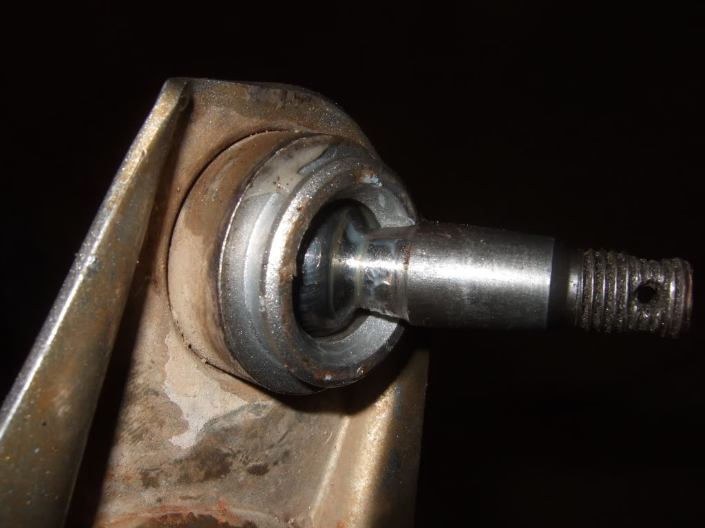

seems like someone done this to the blaster i bought. it are warrior spindels hubs brakess etc
as you can see its welded in place but they are shot so i might need to replace it mmy self.... but dont know what to order
