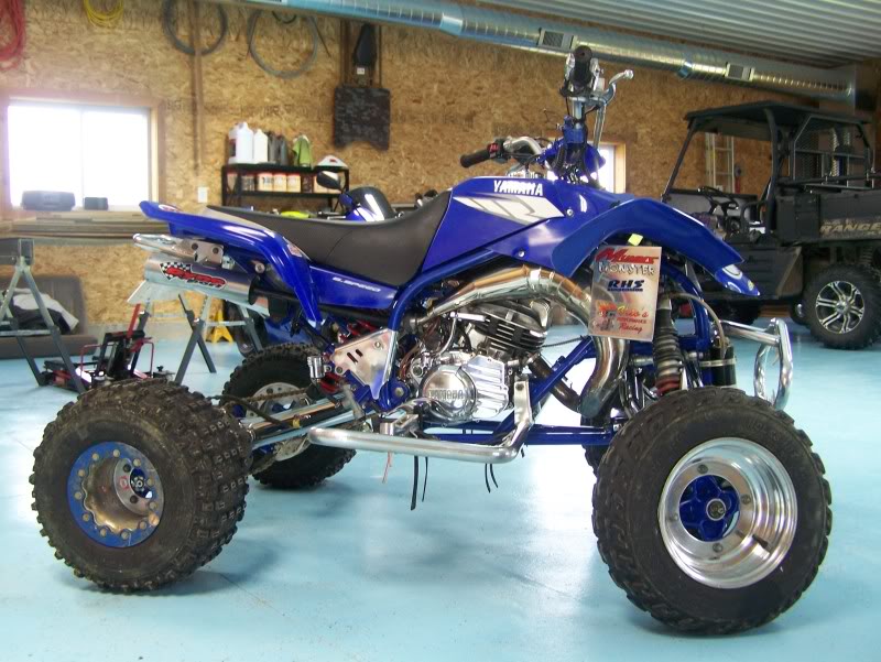

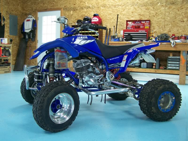

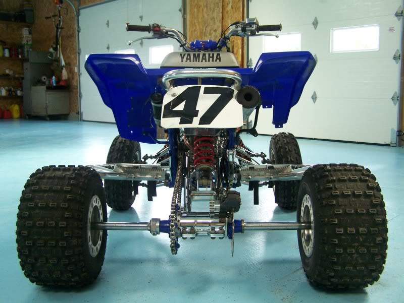

A Arms: +4+1 chrome atv fourplay lt
Swingarm: +3 chrome atv fourplay round house
Steering Stem: stock chromed
Stabilizer: none
Axle : durablue eliminator
Carrier: fireball racing
Locknut: durablue
Hubs F|R: stock / stock powdercoated blue
Bars: stock
Throttle/Clutch Lever: stock polished / stock
Grips: stock
Nerfs: xfr pro pegs
Bumper: jaws
Grab Bar: dg
Front Shocks: custom axis triple rate lt
Rear Shock: custom axis trx250r spring
Brake Lines: steel braided
Rotors F|R: stock / saw blade
Rims F|R: douglas red label / omf beadlocks
Tires F|R: holeshot / turftamer
Body:
Frame: powder coated blue
Plastic: maier race front / stock rear
Graphics|Seat Cover: none / stock
Number Backgrounds: k&k atv
Handguards: none
Bar Pad: none
Fuel Tank: stock
Engine|Drive System:
Cylinder|Head: vito's 240
Bore & Stroke: 72mm & 60mm
Displacement: 244cc
Cam: none
Carburetor: keihin 35mm airstryker
Air Filter|Box: uni / cfm aluminum
Pipe|Silencer: dyno port high volume
Clutch|Plates: ebc
Gearing F|R: 13 / 38
CDI|Killswitch: stock / prodesign
Cooling: cfm air scoops
Other: polished cases, t.m. design works stator cover, works connection frame guard

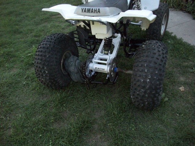

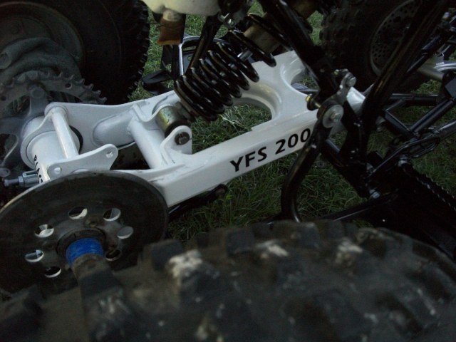

A Arms: Stock
Swingarm: Stock
Steering Stem: Stock
Stabilizer: none
Axle : Stock
Carrier: Stock
Locknut: Stock
Hubs F|R: Stock
Bars: Yamaha
Throttle/Clutch Lever: Stock
Grips: Yamaha
Nerfs: DG Alloy Series
Bumper: Stock
Grab Bar: Yamaha
Front Shocks: PEP Race Shocks with Remote Rezzies
Rear Shock: PEP Race shock with Remote Rezzie
Brake Lines: Stock
Rotors F|R: Stock with Rotor Guards
Rims F|R: Douglas Chrome Offset rims all around
Tires F|R: Holeshot in the fronts Fast Trekkers in the back!
Body: 2003 Stock
Frame: 2003
Plastic: 2003
Graphics|Seat Cover: Has number 5 number plate
Number Backgrounds: Nothing just white number plate
Handguards: None
Bar Pad: Yamaha Dash
Fuel Tank: Stock
Cylinder|Head:
Bore & Stroke: Bored .010 over With Weisco Piston and rings. Cosmetic gaskets
Displacement: 196cc
Cam: Haha none
Carburetor: Stock recently rebuilt and rejetted 300 main jet
Air Filter|Box: Uni Racing Airfilter with Air box lid removed
Pipe|Silencer: Toomey B1 full race system
Clutch|Plates: Stock
Gearing F|R: Srock with New chain cant remember the name.
CDI|Killswitch: Stock
Cooling: Stock
Other:
