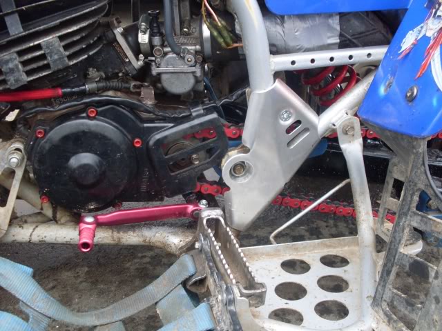

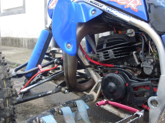

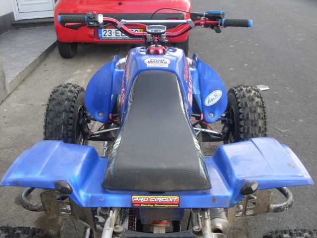

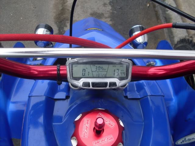

Just a few more pics from recent "small" upgrades.

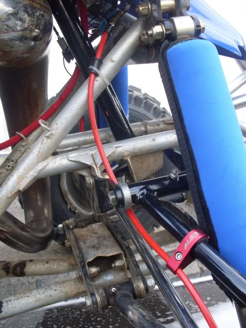

Clutch cable red cover ... Got it from here :) Hydration Tube covers for Camelbaks, Hydrastorm & Hydration Packs this things fit like a charme ! :D

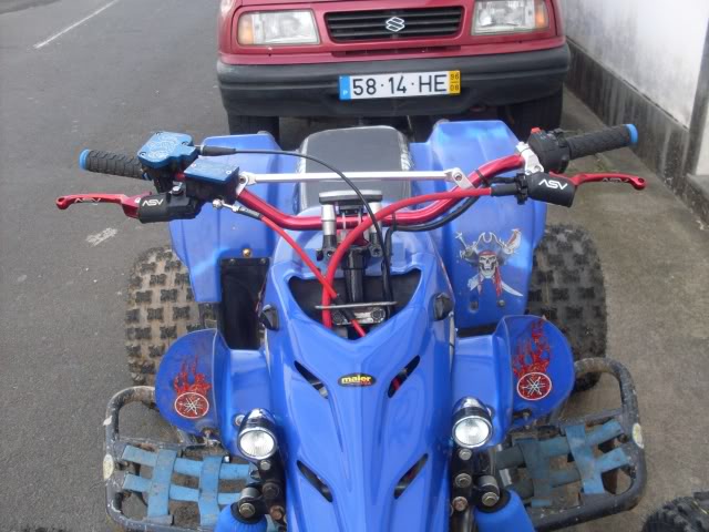

New red... red... red... shift pedal, VENHILL brake lines, cluth cable cover.
detail on RED line and RED Alba Clamp.

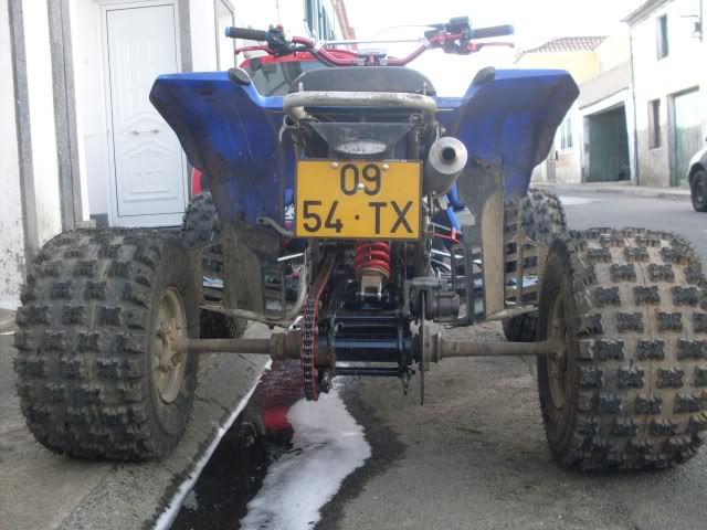

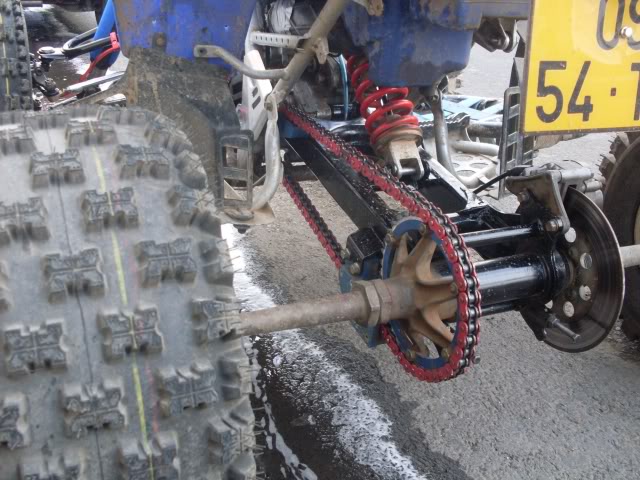

RED 114 links chain (15 front sproket / 38 Rear)

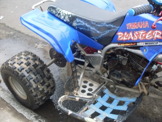

frame guard (both sides) NOT red. :)

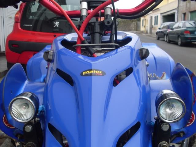

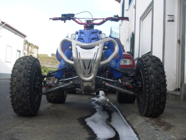

looks awesome. how did you hook the blinkers up? you can make any quad street legal here in arizona, but you need registration, a headlight, a tail light, brakelight, and a horn.
I installed the led relay under the hood (above the cdi box), connected a 12v wire to the relay, passed 2 new wires from the rear blinkers to the relay in the front, the front blinkers where so close that didnt need longer wires... hooked all up, ground evreything to the frame... and of course a handlebar switch.
