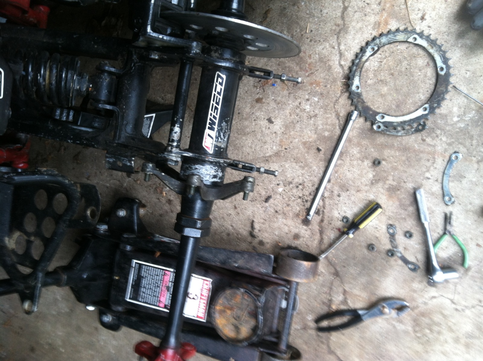

rear sprocket
take off the left wheel and hub and pull off the whole spindle that the sprocket mounts too, then unbolt the sprocket. you may be able to get the sprocket off by just removing the wheel and unbolting it.

. The carrier that actually holds the rear sprocket is a lil loose
If your refering to the sprocket hub (the part that the sprocket bolts to) being loose, You may need to tighten the 2 big locknuts. If its all tight and its still sloppy, your splings may be worn.
Is it loose in the direction of rotation? Or side to side? If side to side you might correct by retightening axle, unless brgs are worn. Have to follow directions else you'll overtighten and blow the brgs
Apply Loctite to rear axle threads.
Tighten inner nut to 40 ft lbs to preload the bearings.
Tighten the outer nut whilst holding the inner nut to 140 ft lbs.
Loosen the inner nut whilst holding the outer nut to 170 ft lbs.
If this way is not done there is a possibility of the nuts becoming loose when riding.
If you add grease under pressure to the carrier, you must remove the inner factory fitted seal from the bearings.
Leaving the seal in place and adding a zerk is a pointless exrecise as no grease will get to the bearings, and could force the seal against the ballrace and cause bearing failure.
Unless you do water, there is no need to fit a zerk add any extra grease to the carrier bearings.
