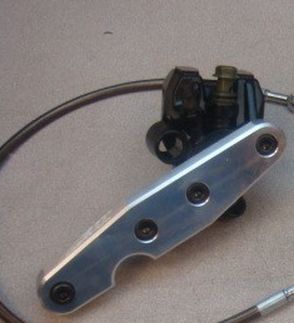

Hello everyone, I'm new to this forum and I'm doing a rear hydro conversion on my 97 blaster. I have everything to do it with except an 03 and up axle carrier. I still have the old style axle carrier and was wondering if there was some kind of adaptor to make the new hydro caliper work on it or would I have to get a new axle carrier?
here's a pic of one that used to be commercially available,
(i think my $100 less gsxr kits put them outta biz ?)
/\ it bolts on in place of the e-brake, which is popular to eliminate with a block off plate
if you search member "best" threads or pic albums, he has one very similar that he built out of 1/4" flat steel,
and bolted his on between the e-brake and caliper, allowing the e-brake to remain.
if you can't find or fab anything, gimme a holler and we'll step you up to a gsxr caliper :)...........
