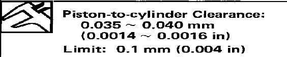

C Cataldi1122 New Member Jan 6, 2012 49 0 0 Jan 27, 2012 #1 Had my top end done, it was bored to 67mm I have a namura piston its 66.92 will this be a good fit?
Awk08 Administrator Staff member Technician Jan 30, 2009 24,427 2,295 175 Usa Jan 27, 2012 #2 heres the piston to cylinder clearences straight from the manual............... did your machinist have the piston while doing the work ????
C Cataldi1122 New Member Jan 6, 2012 49 0 0 Jan 27, 2012 #3 Yes he had it it was measured that's what he said .just making sure tho
Awk08 Administrator Staff member Technician Jan 30, 2009 24,427 2,295 175 Usa Jan 27, 2012 #4 you should be good.
slickerthanyou New Member Dec 23, 2009 7,615 140 0 Jan 27, 2012 #5 awk08 said: heres the piston to cylinder clearences straight from the manual............... did your machinist have the piston while doing the work ???? Click to expand... Cataldi1122 said: Yes he had it it was measured that's what he said .just making sure tho Click to expand... 67mm = 2.637795 inches 66.92mm=2.634646 inches That piston has .003149 clearance
