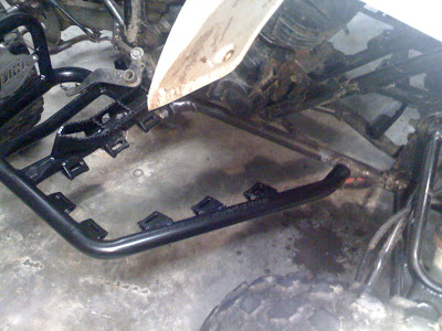

there was 2 problems that i had with them.

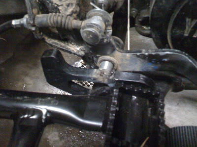

1 - the rear brakes would not mount up because the stub was in the wrong spot. i cut it off and welded to where it should be.

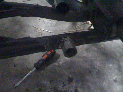

2 - not sure if it was my exhaust but it would not fit over the front frame rails.
so i cut the nerfs a little and welded a mount point to the frame and connect the nerfs to this. this would also let me take them off when i wanted.
i will try to snap some pics tonight.
here are some pictures..

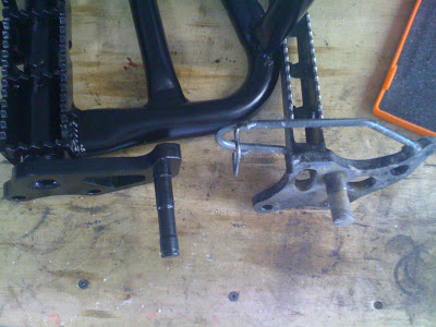

*EDIT* wait did you mean making them fit only for older once, do they fit nice on a 03? and is it just me or is the foot peg like bent over and not 90 dagrees
Here is a picture of my foot peg and the foot peg of the one on the nerf bar.
if your brake connects in the back you will be ok..
Yea, you should be good then. i called DG the other day and they said they are for 03 + Blasters.
it looks like it will bolt up nicely.
