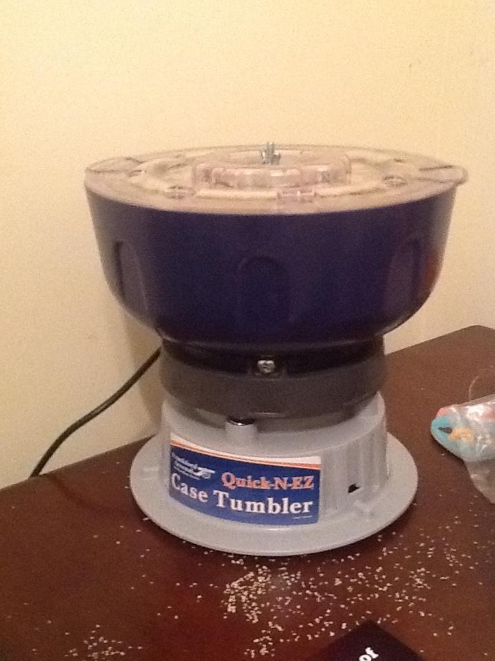

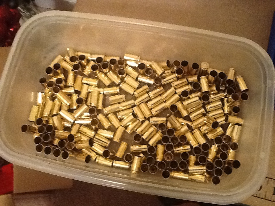

Not blaster parts but still very shiny (iPad pic doesn't do them justice).
$50 will get you set up to clean and polish pretty much any small parts. I use corn cob media and just add in some Nu Finish Polish and let it run for a couple hours.
