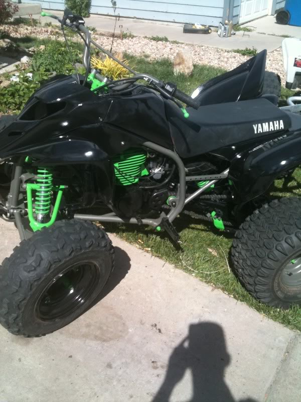

Believe it or not but my plastics had rhino lining and blue paint on them when i got them, after peeling the rhino lining the paint was left all splintered and all. so alot of sand paper and many months of work. they are black and shiny
Before::::
After::::::

Whisle that's some nice blaster and you put raptor 250 plastic on I'm guessing. Thars a good paint job best I've seen in a while

hey beaster blaster your plastics look great man i might use your idea and if buy any chance could you pm me about how many cans of paint you used.
