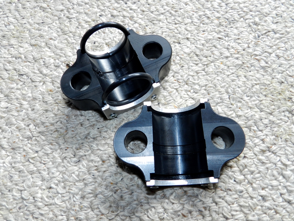

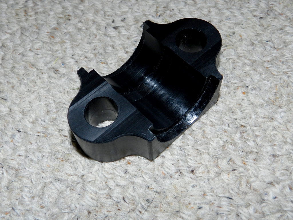

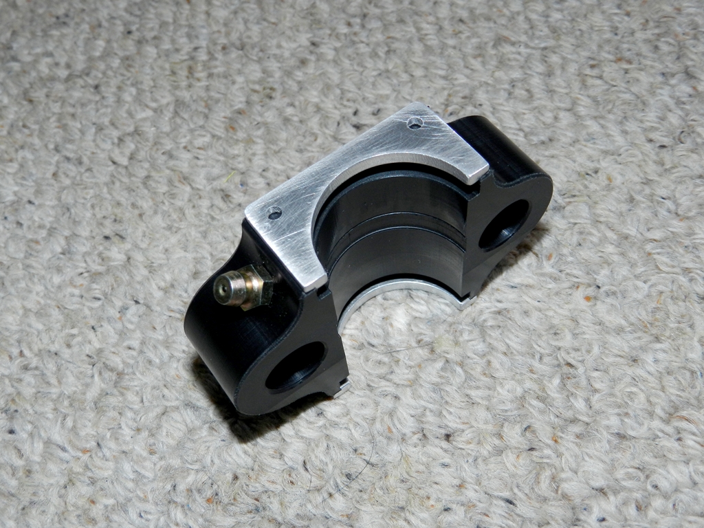

After stripping my quad to get it powered I found out the OMI bushing had a problem. I had installed it with grease on the o-rings and o-ring grooves and grease all on the inside of it.
But the ends have started popping out so did some measuring. Found out that the 0-ring slot is 3mm wide and the o-ring is 3.5mm wide.
The lip / edge is only 1.6mm thick so bends easy. I dont no way they didnt make it 3 times as thick as there is lots of room.
Don't think I want to use it now. Was thinking about removing the lip that is bending out and making a new aluminum plate that goes of the outside held on with 2 little bolts threaded into the bushing. wound need to make 4 of the one of each side of both bushings.

Wow! I can see how the lip, edge is bent in pic.
How well did the o-rings fit in the o-ring grooves before you installed it?
The o-rings fit in mine very nice. you can see that in my pics.
I will take a look at mine to see if it looks like the lip edge is bent. :confused:
O-rings fitted tight in grooves and I would say when the 2 bolts got done up it would have made it a even more tight fit and pressed the edge out.

Just looked at your photos close up. Looks like your one maybe pushing up?

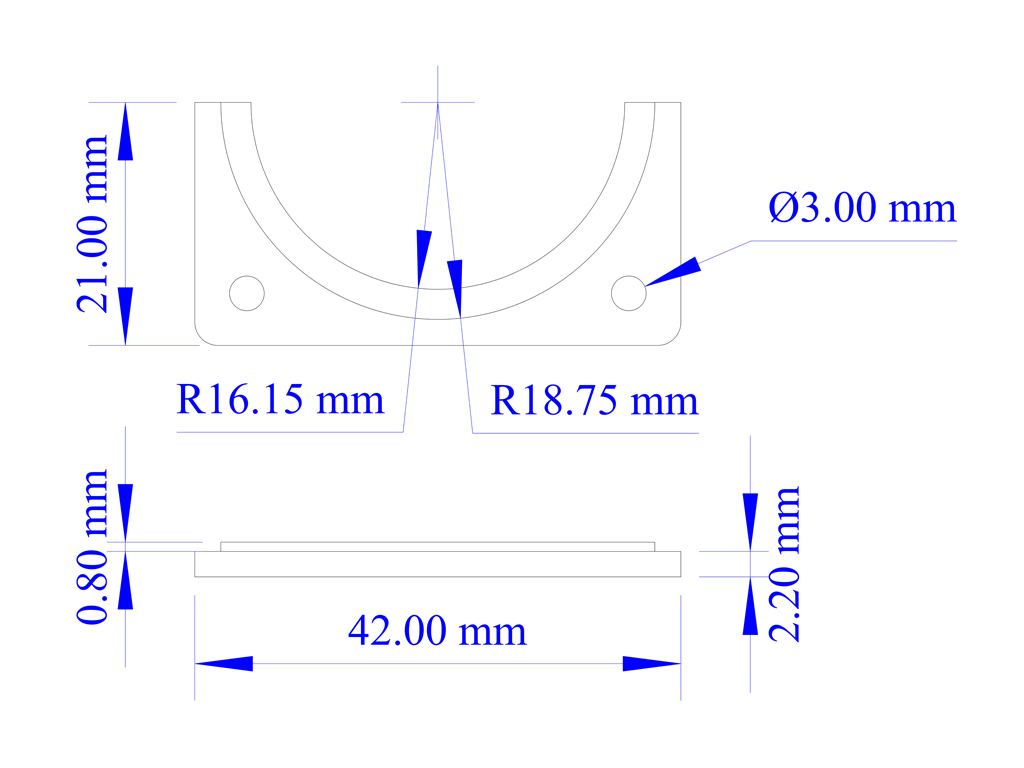

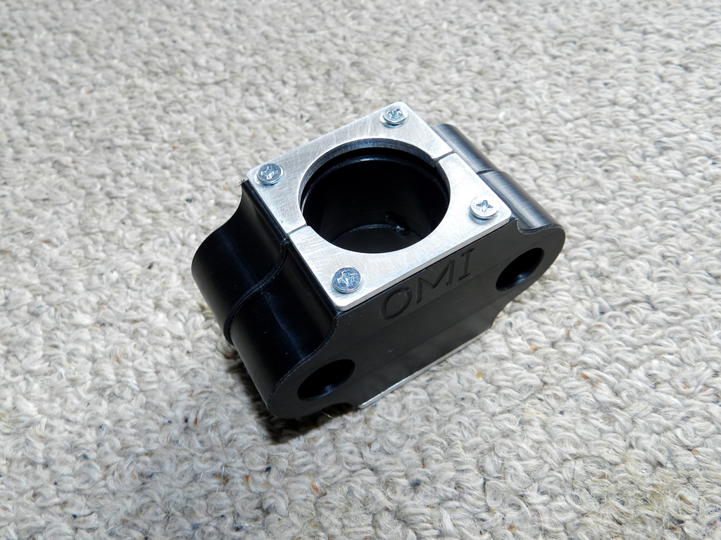

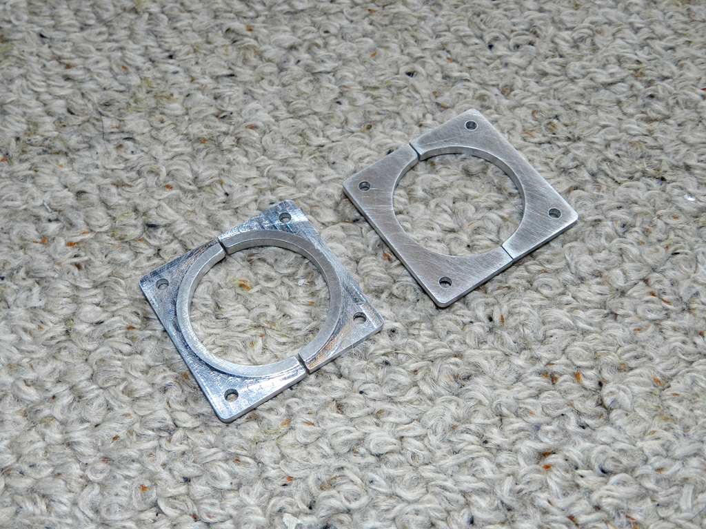

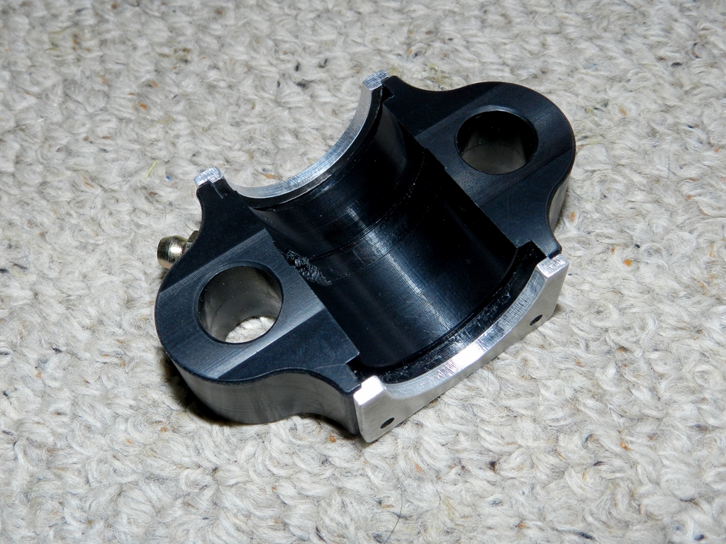

Got my aluminum parts today to modify the OMI clamp.
Cut the lip off.
Nice fit. Also the o-rings fit a lot better now that I made the slot 3.5mm wide.
Just need to get some screws or bolts now.
Download PDF: HERE
Download DXF: HERE
