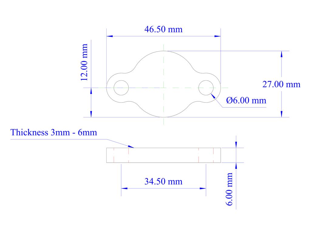

Hi all. Just drawn up the block off plate for the oil pump delete. You will need one gasket and two m5 x 0.8 Allen key button head or normal bolts 12mm long if you make the plate out of 6mm aluminum. Short bolts needed if you make you plate thinner.
PDF Download: http://www.4shared.com/office/GT-gzYlkce/Oil_Injector_Block_Off_Plate.html
DXF Download: http://www.4shared.com/file/NaOaWm6Vba/Oil_Injector_Block_Off_Plate.html
Might help if some one wants to make there own.

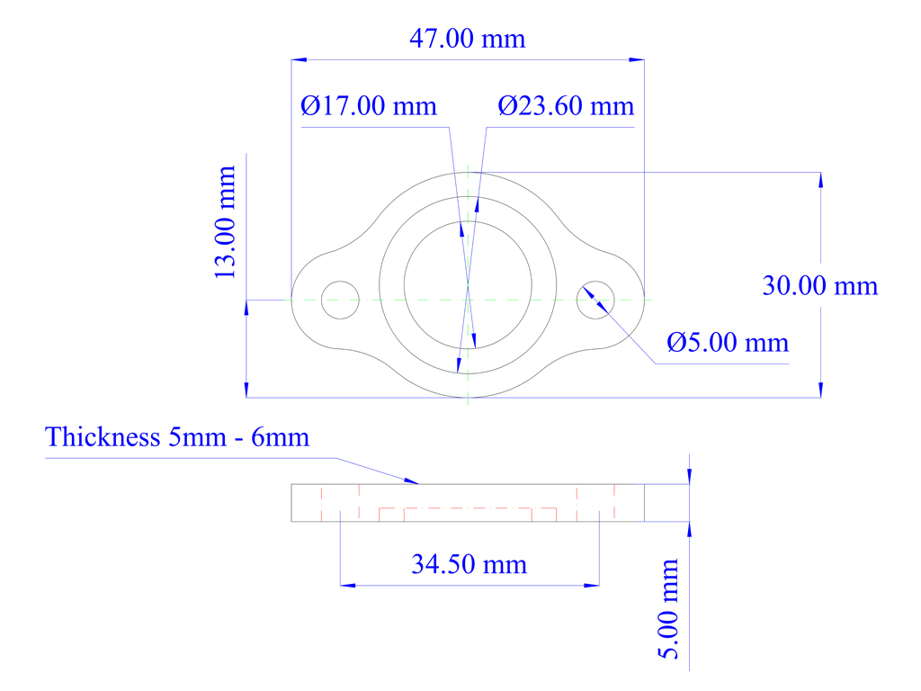

Will be drawing up another one that uses a o-ring.
