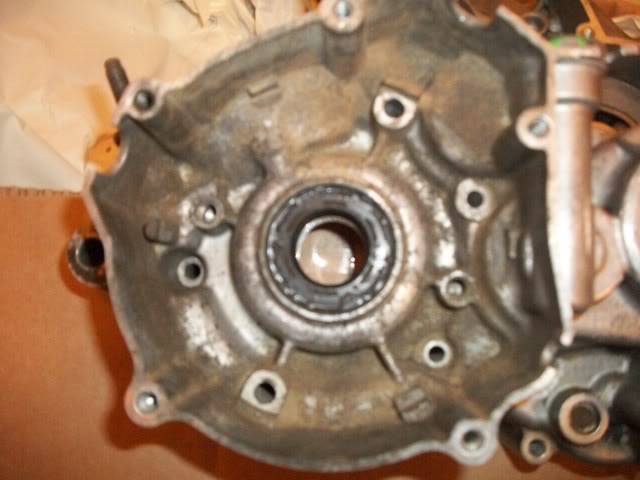

You mention top end rebuilds, but nothing about new crank seals or ect. If you have a also a crack in the inner cases, it needs fixed.
I leak down tester is a must !
And weisco is about the best piston out there, compared to the cheaper ones.

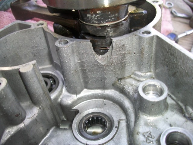

I bet more than likely you have a crack or damaged case.
there is 2 ways to see this.

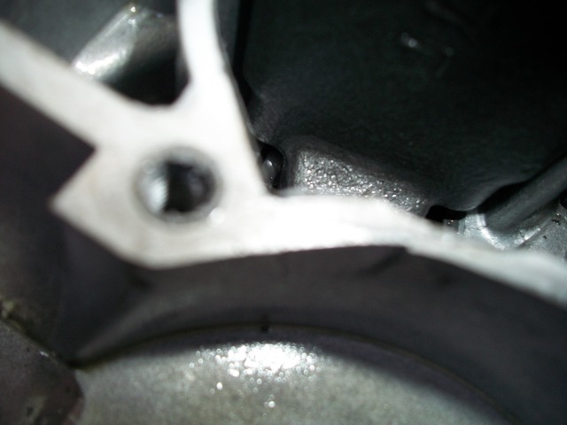

1- take a flash light and look into the rod and crank and rotate the rod and crank. while doing this. look inside in the middle, this is where the two case halves come together. you will be able to see that area on the back upper side.

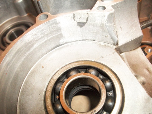

this is common area where damage happens from a broken piston.
its not a true check, but its something.
I recommend, new crank seals and gaskets and splitting the cases and looking at the inner case for damage.
Do it right and you wont have to go thru this again anytime soon.
here is a few pictures of what I mean of inner case damage.
CRACKED, see below
