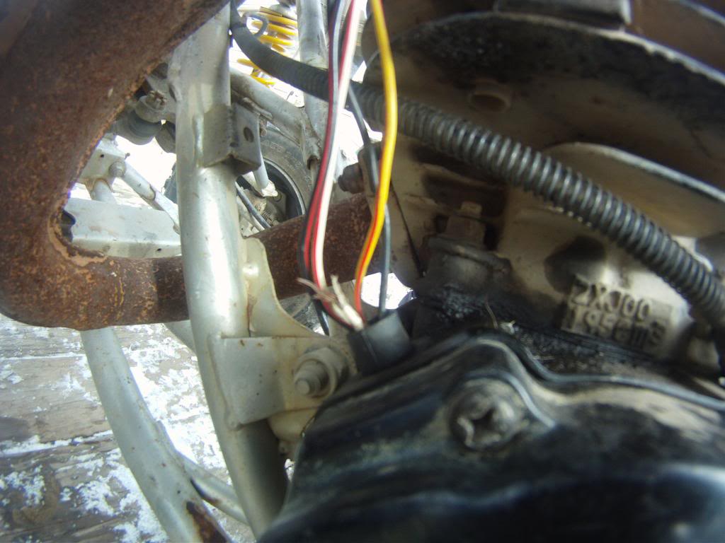

There is a white wire that was cut an inch from the stator that is not hooked up.

There is no white wire coming out of the stator on a Blaster wiring.

here is the white wire im talking about

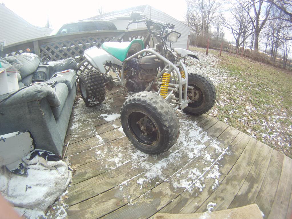

my blaster as i am working on it. Its like 28 degrees out but after kicking it over so much im sweating
