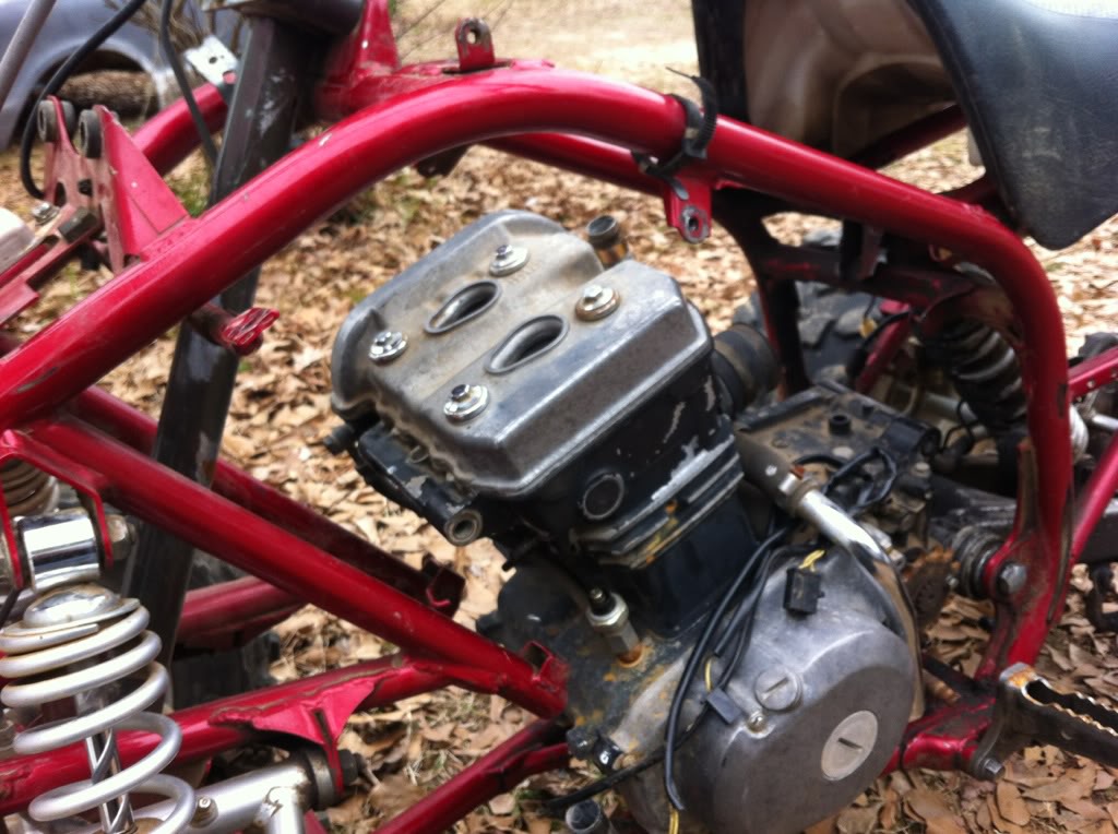

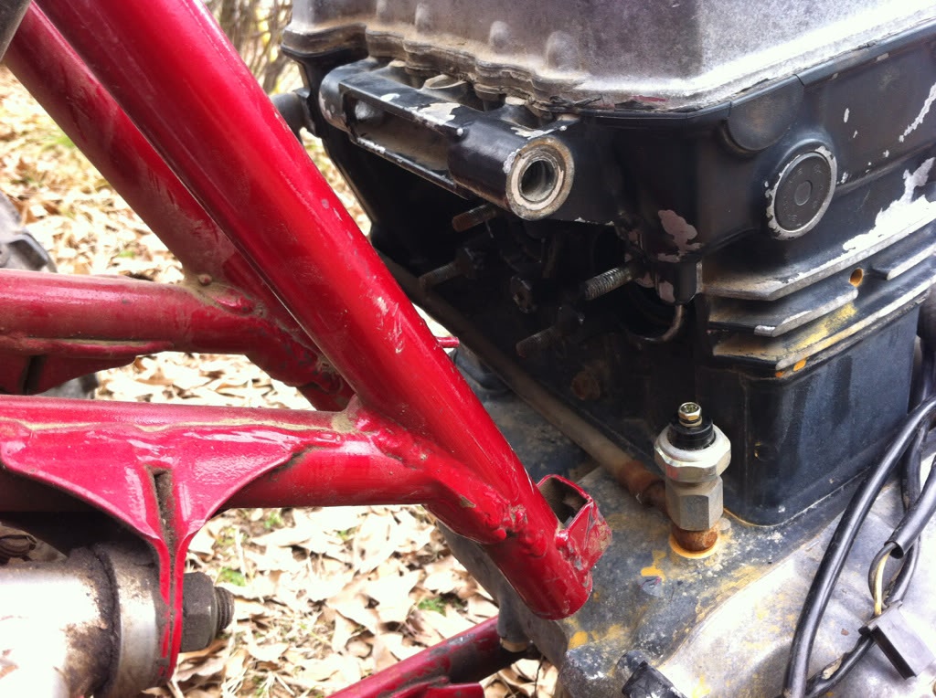

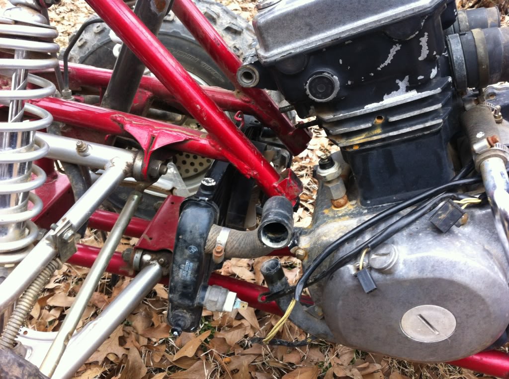

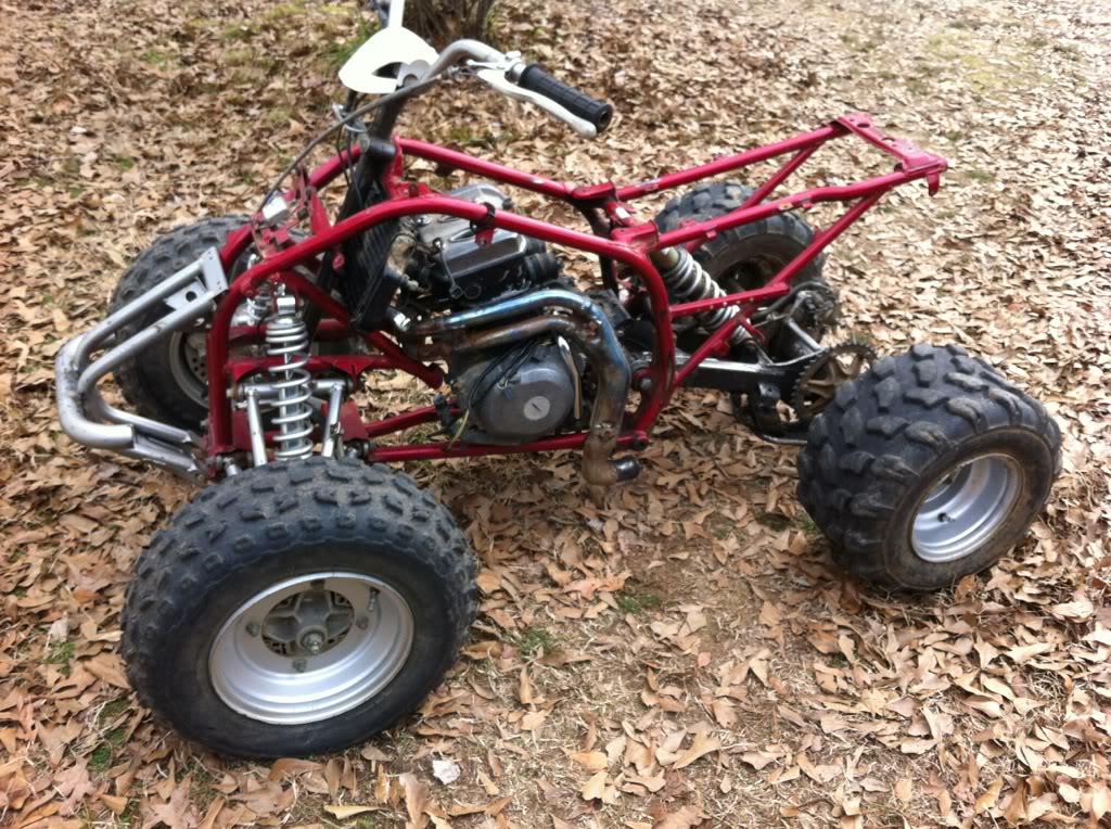

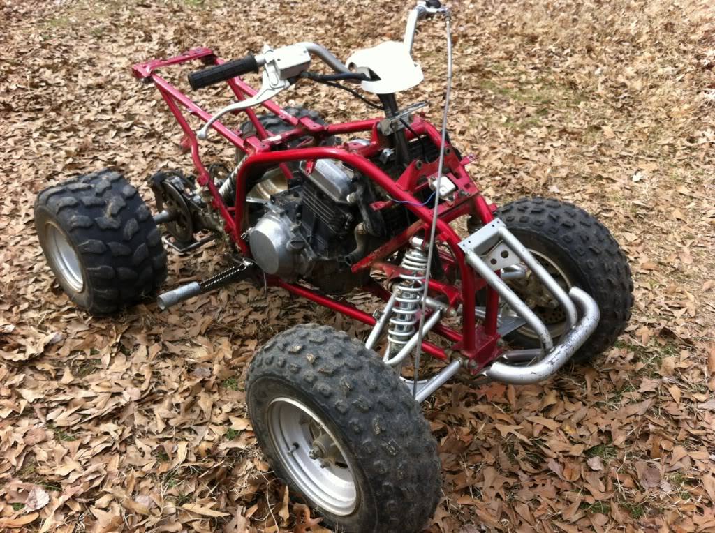

So far ive just got the frame modified to where i can sit the motor on it. i need some ideas for the raditor or what other raditors i could use and some ideas on the exhaust. I got the the blaster last year for 300$ and it was running. i even got 2 extra exhaust, another bottem end and another cylinder with it. well after a couple months later i already had to rebuild the top end once and then on seperate occasions i had to replace the crank twice! after this last time i decided to get a different motor. At first i thought i was gonna have to use my 1974 kawaskai 250 2 stroke motor but then i finally found something worth getting last week. i got a kawasaki el250e elimintor motor (came with everything for it to run except for cdi box) for 60$. the motor is the same motor they used for the ninjas and so i ordered me a ninja cdi box for 32$ off ebay and im currently waiting for it to come in, and later i might even buy the cams from a ninja motor to put in it just to be sure it runs the the ninja. Also i need some ideas on air filter set up
