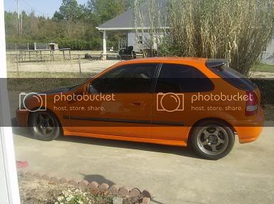

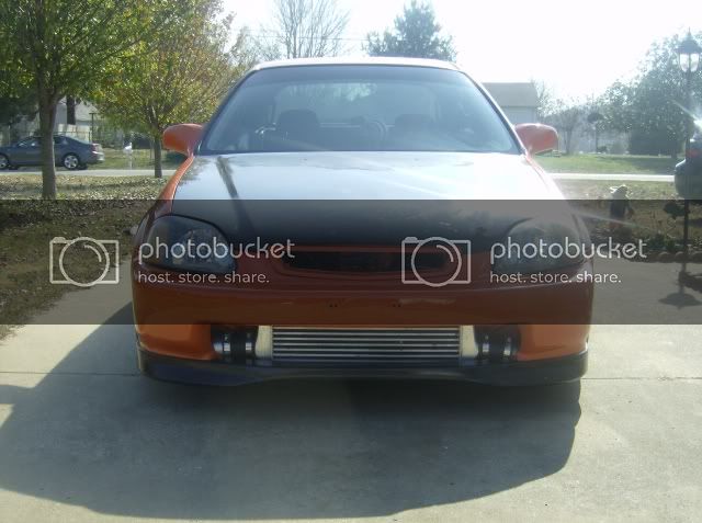

Well,since the other guy posted pics of his car I figured Id post mine too..
I love to whore out pics of my junk...I:I

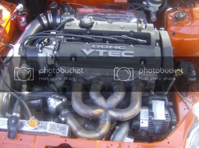

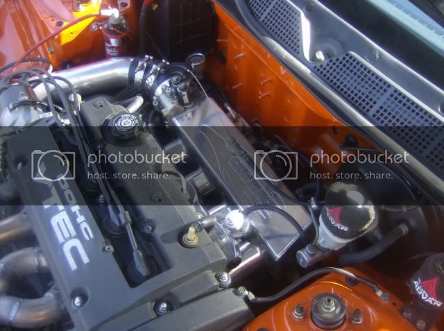

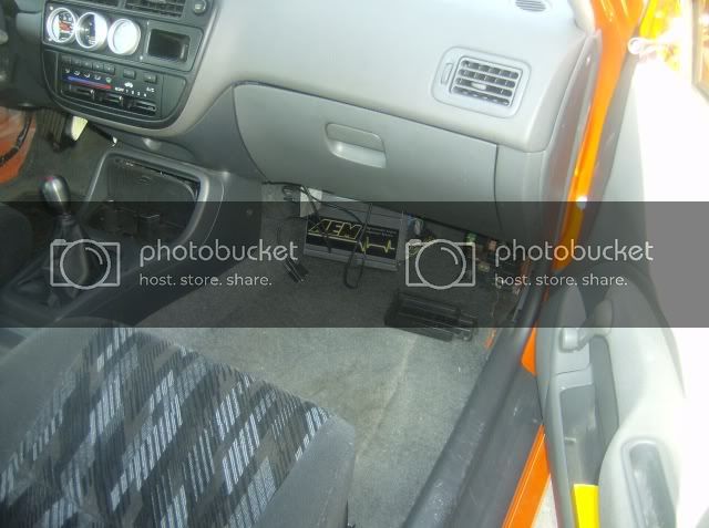

ppg bright orange with a fuk ton of different pearls, H22a4 block with darton DS-200 sleeves, CP pistons 10:1, eagle rods, h22a1 head, supertech valvesprings, titanium retainers, ss nitrate coated supertech valves, golden eagle intake manifold, and 1000cc injectors. Fed by precision GT35R twin ball bearing charger and a custom turbo manifold..............all controled by an AEM EMS
Made 386hp on 8lbs,and 598hp on 24lbs of boost.
nice, how do you get traction with that thing?

It never really has traction,but on slicks it does okay,once you get to second gear.. I use launch control through the AEM as well..

i saw the 1000cc's injectors before the turbo and was like man thats overkill, then saw the GT35R and was like YES. lol. that exhaust manifold is pretty crazy lookin. and 24 psi? thats sick. 386hp @ 8 psi is very impressive also.

I was able to make good power at low boost,cause of the higher compression...
Nice ride. That thing is no ricer. thats called a killer right there.

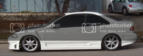

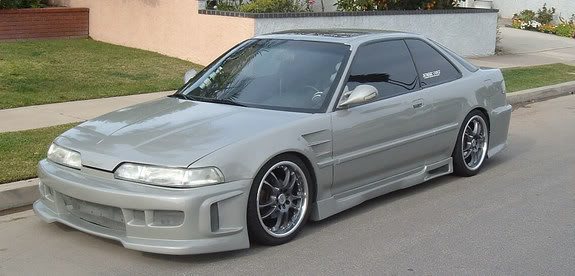

Heres a pic of my old DA and My brothers old EG.
Both cars just had just the bolt ons as we were more into show than speed. But, within the next few years I am going to build another honda.
We sold both cars, had to because of our line of work lol...but I found out that the DA is some where rolling around Mexico right now! To bad somebody didn't take care of the car like I did.
