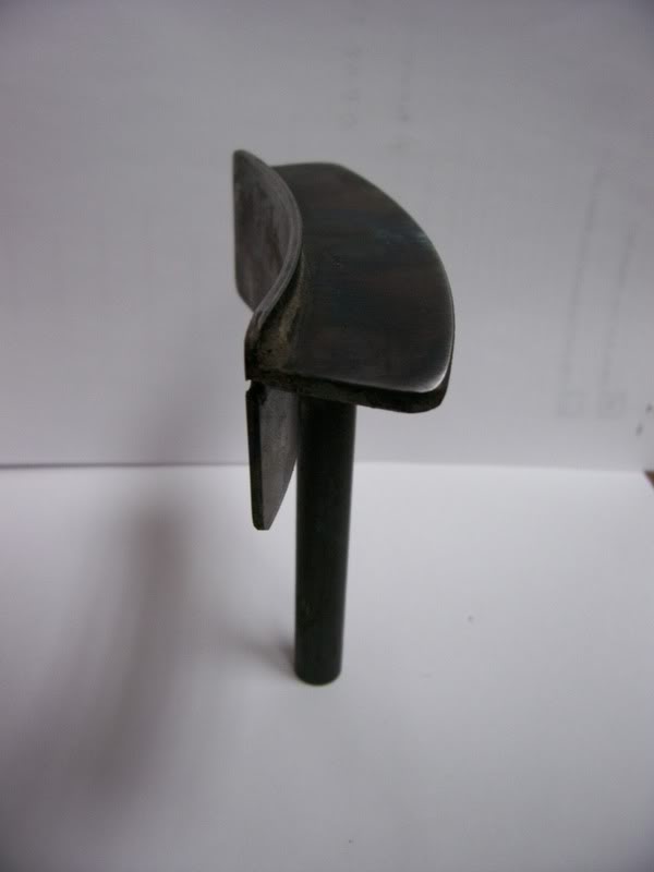

I mount my own tires on my atv's, once you figure it out it goes easy. I made a special tool to break the bead as that is the hardest part. I Remove valve stem core let all air out and I put this took in my drill press (this is only used as a press dont turn drill on) and work around the tire. once bead is off on both sides soap up rim and work off (you can turn rim sideways to work out with tire irons as needed). soap up new tire bead and put first side in then work second bead with tire irons. set bead with a burst of air (valve stem core removed to inflate fast)
then air up till the bead sets (may take 40 psi and watch fingers as it will pop in place very fast) air back down install stem core and air up.
