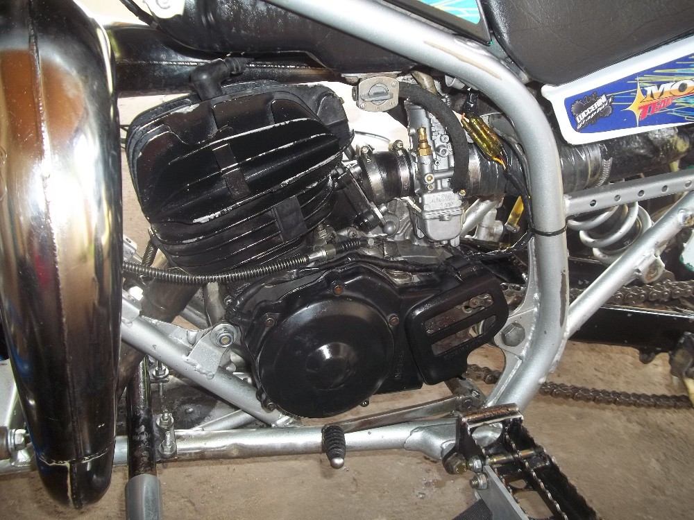

I am from Argentina and I own an old 1994 model blaster.
mmi blaster, owns carburetor honda cr 250) mikuni). the problem is difficult to start.
also has GYTR air filter and flappera VFORCE 3 with carbon sheets.
which may be the problem??

Couple thing I see in the pics that could cause you some problems down the road. Is that flex duct your using to go from carb the filter? Your chain looks really loose too.
Like AWK said if that cylinder isn't ported and the head isn't cut the carb is to big. Has it ever ran good since you put that carb on?

The problem lies with the big bore carby.
At low revs the speed of the incoming air is not adequate to draw fuel into the venturi.
At high revs the speed of the air is increased, therefore making it easier to draw fuel through the jets.
Reducing the bore size of the carby will solve the problem.
The hose which comes from the air cleaner to the carby is also creating a problem, the uneven internal surface will be creating havoc with the air flow.
Trying to jet such a large carb will leave you without much hair, you will be pulling it out often.
I am not saying that it cannot be done, but you may need to experiment with lots of jets, jet needles, needle jets, maybe pilot jets, slides and float level settings, plug chopping at each change.
If you are going to try, firstly remove the corrugated feed from the air filter and replace it with a smooth surfaced one.
