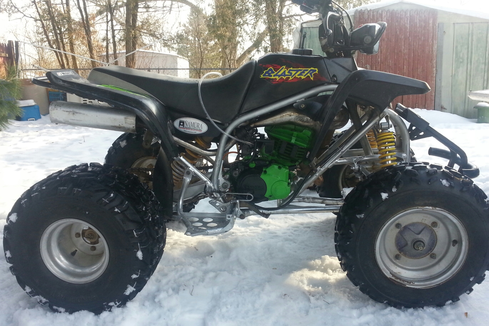

A Arms: stock
Swingarm: stock
Steering Stem: stock
Stabilizer: none
Axle : stock
Carrier: stock
Locknut: stock
Hubs F|R: stock
Bars: stock
Throttle/Clutch Lever: stock
Grips: PROtaper pillowtop
Nerfs: none
Bumper: DG
Grab Bar: stock
Front Shocks:stock
Rear Shock: stock
Brake Lines: stock
Rotors F|R: stock
Rims F|R: itp
Tires F|R: Titan fast trekker
Body: stock 88-02
Frame: gusseted, painted
Plastic: blue
Graphics|Seat Cover: Nstyle graphics kit, Nstyle seat cover
Number Backgrounds: none
Handguards: none
Bar Pad: stock
Fuel Tank: stock
Engine|Drive System:
Cylinder|Head: stock
Bore & Stroke: stock
Displacement: stock
Cam: stock
Carburetor: stock
Air Filter|Box: uni filter
Pipe|Silencer: fmf gold series fatty, turbine core 2
Clutch|Plates: stock
Gearing F|R: 14/40
CDI|Killswitch: stock
Cooling: air cooled
Other:

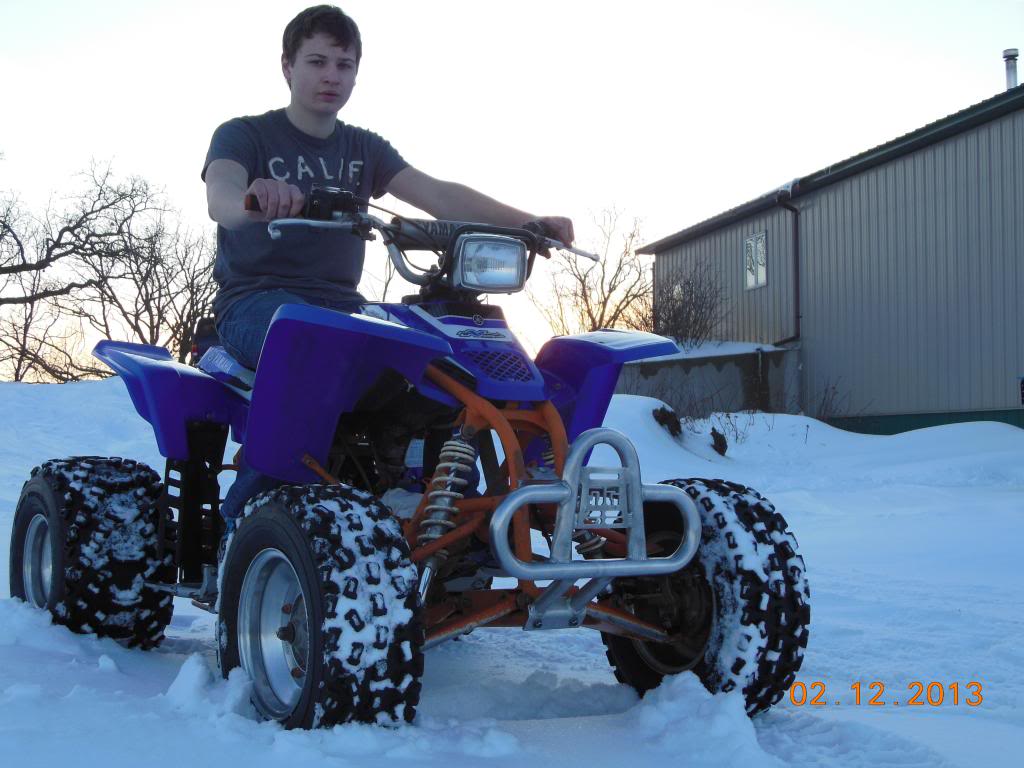

A Arms:stock +3 stud spacers
Swingarm:stock
Steering Stem:stock
Stabilizer:none
Axle :stock +3 stud spacers
Carrier:stock
Locknut:stock
Hubs F|R:stock
Bars:Fly v bars
Throttle/Clutch Lever:stock
Grips: spider grips
Nerfs:none
Bumper:stock
Grab Bar: yes its stock and painted
Front Shocks:stock
Rear Shock:stock
Brake Lines: stock
Rotors F|R:stock
Rims F|R:stock
Tires F|R:dunlop for dirt, gbc sandsharks for sand!
Body:stock
Frame: 1988 stock
Plastic:stock
Graphics|Seat Cover:ceet racing
Number Backgrounds:
Handguards:none
Bar Pad: Protaper
Fuel Tank:stock
Engine|Drive System: stock
Cylinder|Head: SCD rechambered
Bore & Stroke:68mm
Displacement: around 205?
Cam: hell no
Carburetor:stock mikuni 26mm
Air Filter|Box: maxima profilter
Pipe|Silencer:Full CT right bend
Clutch|Plates:stock
Gearing F|R: 13/40
CDI|Killswitch:stock
Cooling: custom air scoops
Other: nacs bar clamp, pep shock covers, 03+ hood and light conversion

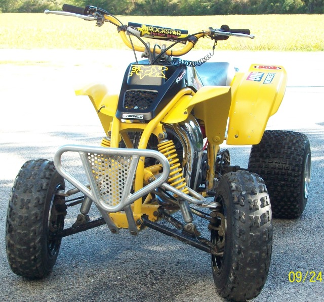

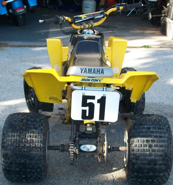

A-Arms: Stock, painted black bottom a-arms, and 93' stock silver upper a-arms.
Swing Arm: Stock length, black pearl flake paint job.
Steering Stem: Stock
Stabilizer: None
Axle : Stock
Carrier: Stock with Zerk fitting for adding grease to the swing arm bearings
Locknut: Stock
Hubs F|R: Stock front hubs with black paint | Rear hubs are off of an 87 banshee.
Bars: Pro taper 7/8 bar painted yellow.
Throttle/Clutch Lever: Motion Pro twist throttle |New stock clutch lever and new clutch cable.
Grips: Pro Taper stage 3 black half waffle grips new
Nerfs: None not a fan of them
Bumper: AC front grab bar
Grab Bar: A stock but new grab bar
Front Shocks: Stock yellow shocks
Rear Shock: Stock yellow shock
Brake Lines: Brand new front break cables
Rotors F|R: Stock 02 hubs/rotors
Rims F|R: Front rims are regular aluminum. Rear rims are from 95' and are aluminum as well.
Tires F|R: The front tires are 19-7-10 Holeshot MXR4's tires with 80% tread left. Rear tires are turf tamers new in 95' with 90% tread left
Body:
Frame: Custom painted 2002 sun yellow frame
Plastic: Gloss yellow plastic front and back fenders. The tank and hood are also repainted black.
Graphics|Seat Cover: Stickers are AMA, Boyesen, FOX, Maxxis, Metal Mulisha, Moose Racing, Motion Pro, Renthal, Rockstar, Vortex, VP, UNI, Wiseco.
Number Backgrounds: #51
Hand guards: None
Bar Pad: Rockstar energy bar pad an 09-10
Fuel Tank: Standard capacity with a shiny new Tusk gas cap.
Cylinder|Head: Stock as far as I know PSI is at 127
Bore & Stroke: 66mm with 57mm standard stroke.
Displacement: 195cc
Reeds: Boyesen Pro Series Reeds
Carburetor: Kehin OKO 30 MM carb with 50 Pilot and 148 AB main jet
Air Filter|Box: UNI stage II POD filter
Pipe|Silencer: Toomey B1.
Clutch|Plates: DP clutches
Gearing F|R: Stock gearing
CDI | Killswitch: Pro Armor tether kill switch.
Cooling: Air Cooled with the help of 93 octane premium mixed with Amsoil Dominator at 32:1

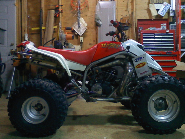

A Arms: stock painted
Swingarm: stock
Steering Stem:stock
Stabilizer:N/A
Axle :stock
Carrier:stock
Locknut:stock
Hubs F|R:banshee
Bars: bmx
Grips: oury
Nerfs:tusk
Bumper:tusk
Grab Bar: dg fat
Front Shocks: FOX racing
Rear Shock:z400
Brake Lines:stock
Rotors F|R:banshee
Rims F|R:stock, itp baja
Tires F|R:stock, itp holeshot
Body:
Frame:stock
Plastic:stock
Graphics|Seat Cover:stock
Number Backgrounds:stock
Handguards:none
Bar Pad:none
Fuel Tank:stock
Cylinder|Head:KOR ported, rechambered head
Bore & Stroke: 67mm
Displacement:201cc?
Cam: mr cleans hair
Carburetor: 30mm OKO
Air Filter|Box:uni
Pipe|Silencer:fmf sst
Clutch|Plates:tusk
Gearing F|R:13/40
Cooling: the air
Other: sexyness, amr monster coil.

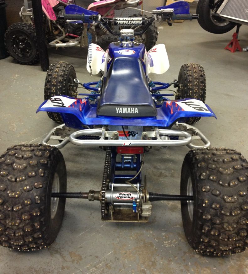

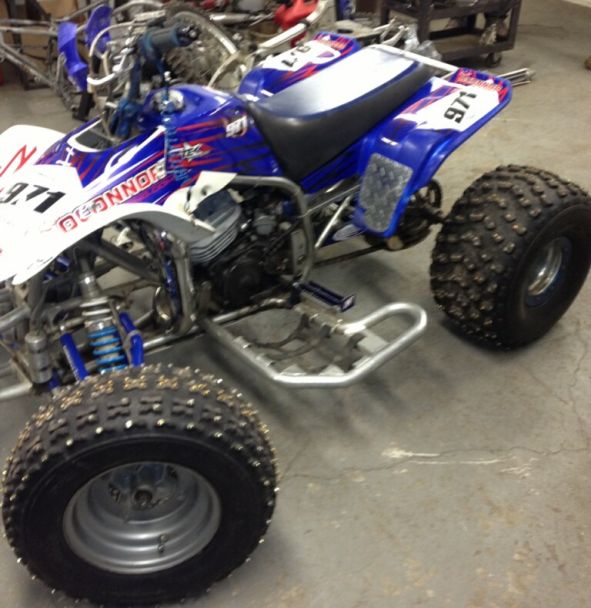

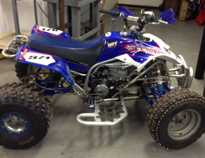

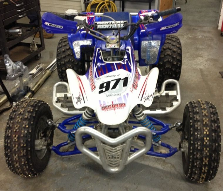

1. A Arms: ASR +3 +1
2. Swingarm: T-ROK +4
3. Steering Stem: Stock raised +2
4. Stabilizer: None
5. Axle : Banshee
6. Carrier: Stock modified for Banshee rear brake
7. Locknut: Stock
8. Hubs F|R: Banshee front, stock rear
9. Bars: Renthal
10. Throttle/Clutch Lever: Stock throttle, CR 250 clutch lever
11. Grips: Oury with vibration dampeners
12. Nerfs: Not sure who made them but they’re on .
13. Bumper: DG
14. Grab Bar: Tusk.
15. Front Shocks: Works with remote reservoirs.
16. Rear Shock: 400EX
17. Brake Lines: Speed lines
18. Rotors F|R: Banshee
19. Rims F|R: Front are stock, rear are Bead locks
20. Tires F|R: Front are Holeshots Rear are Kenda Claws
Body:
1. Frame: T-ROK gusset
2. Plastic: Maier Hood, Stock for the rest
3. Graphics|Seat Cover: Custom TEK, 971, KOR Theme. Seat cover is stock.
4. Number Backgrounds: TEK
5. Handguards: Tusk
6. Bar Pad: Renthal
7. Fuel Tank: Stock
1. Cylinder|Head: KOR designed head, KOR ported cylinder. 240 LA sleeve.
2. Bore & Stroke: 73mm x 61mm
3. Displacement: 255 cc
4. Cam: Uhhhhh……No
5. Carburetor: 35mm PWK
6. Air Filter|Box: K and N filter with CFM air box
7. Pipe|Silencer: CPI
8. Clutch|Plates: Vesra plates with special springs. I’m not tellin
9. Gearing F|R: 13 / 40
10. CDI|Killswitch: Tether
11. Cooling: Mother Nature
12. Other: One bad ass Banshee killer!!!!!
