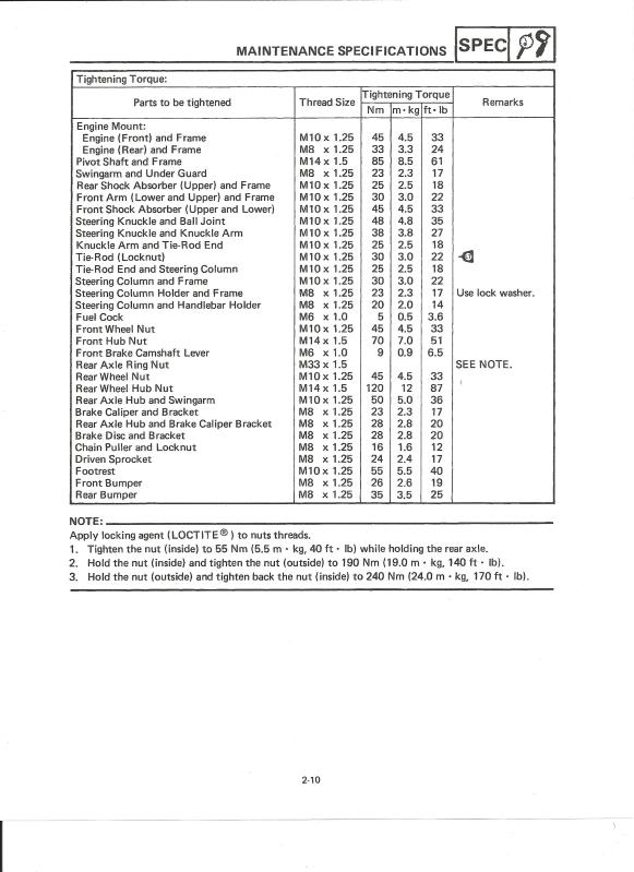

Does anyone know the thread size and pitch for the lower ball joints? The threads on both sides of the newly acquired blaster are buggered up, and the nuts will only make it halfway down the threads and its not safe to ride. I know new a-arms would be the best answer but, I was thinking i could run a die down to clean up the threads.
looks like m10 x 1.25
