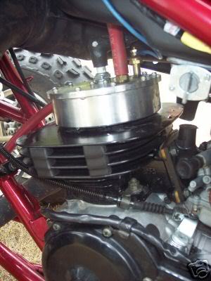

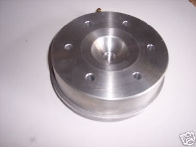

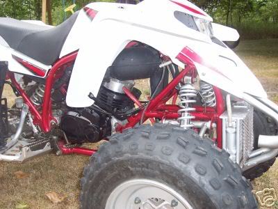

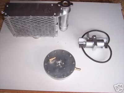

damn... i want to put a 240 kit on it so i think il buy the liquid cooled head from Yamaha Blaster High Performance Liquid Cooling Kit because he can mill it to anysize i think... btw putting a dt 200 engine in it doesnt make sence.. its not a blaster anymore if u put a dif engine in.. i mean its cool if i put like a 300cc engine in then its kickass but a 200cc bike engine in is kinda dumb dont u think? id much rather buy the liquid cooled blaster head.. no?
Yea i would go with this kit if your doing a 240. Anyway with the extra heat from a 240 your going to need it. Looks like it would be awsome. Looks like it runs off of a vaccum pump. The guy says he has some for the vitos 240 kit. Let me know if you get a kit im interested in them too. There is one on ebay right now.
