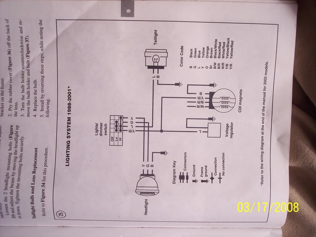

Ok so when i got my blaster off some guy, they had it all messed up, including some banshee lights on it, that were screwed into the fenders on the sides, and just hanging there, they lit up, but very dim and all the time whether the lights were on or off, so i just cut the wires to the kill switch and lights, then they still stayed on all the time, and i wired up the bike to run on only the key, i couldn't figure it out at all, then i realized the voltage regulator wasn't hooked to the lights of to the chassis, so i didn't know what to do, i've been looking at wiring diagrams and just can't figure it out, if anyone can help me in educating me a little in how to wire up a light or two, i'd greatly appreciate it, thanks!
I used this it helped so much!

Well this is a pretty easy problem. If you have the diagram its easy. If not, just buy a light or use the ones you have and get a different bulb. Show us the light and we can offer help. The light switch, use the yellow or green wire off of it for the postive and the black one for the negative. If everything else is hooked up it should work. If they are wired into the wires feeding the switch they will stay on all the time. You should use like 20w bulbs also. IF you need a light switch I have one for $5 plus shipping. Then you would have the stock plug in.

Alright thanks for the help guys, i just finally got them put on, although it's 2 in the freakin morning, haha. Just finally got around to it today, i hope i wired it alright, my stock light switch went crazy after i broke my handlebars once, but i'm using the switch that came with the set, and i went and got the 20 watt halogens from lowes. fit right, i mounted them to the original holes for the mounting hardware on the stock light, that was still on my bike, haha. And i got it all wired, i went straight from the yellow/red wire, to the power on the switch, (which had a fuse in it so it doesn't fry), then from the switch it branches off into the two lights, and where i spliced that together i spliced the 12v regulator in right there, and then grounded out the switch and the lights. Hope it works right, i'll test it out in the morning when i head to the track, just a little late to start the motor. haha, will post pics
