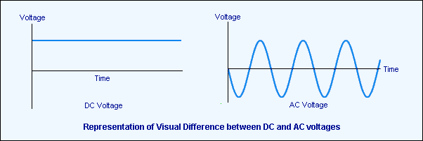

Ok let me explain a little more, here is a graph on the 2:
With DC currnt you have constant voltage the entire time. But with AC current, you will only have power flowing to the LED when the curve is at its peak. So everytime it peaks at the bottom, no current to the LED. So you will have flashing lights the entire time. An LED actually ALREADY flashes on and off, just really fast so our eyes cant pick it up. but if you have every watched an LED through a camera or something you will notice it due to the exposure of the camera. So with an already flashing LED and then you add current that makes it go off an on, it gets really confised as to when it should light lol
