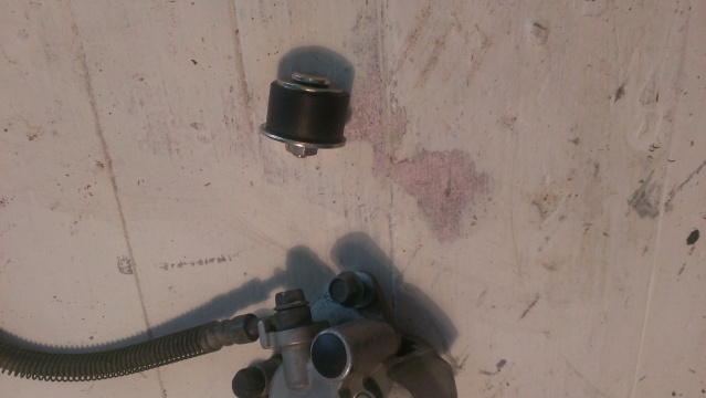

I recently build a leakdown tester and now all I need is an exhaust blocker if you know what I mean. Where might I be able to find a freeze plug for that will fit the exhaust? And would the size be 1 and 3/8 to 1 and 1/2?
Thanks

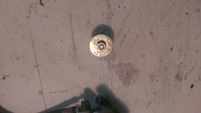

This is the one you need: I purchased it from O'Reilly auto parts, the ones they sell for plumbing at Home Depot/Lowe's wont work.
The one I posted will work with a stock cylinder, I tested it on my spare a few months ago. I would get you a measurement, but that cylinder is somewhere in CT getting worked over right now.
i send out the 1-1/8" to 1-1/4" expansion plugs from advance auto with my testers.
i'm told they work.
btw...a ported exhaust is ported on the cylinder side, the pipe side should still be the same original diameter as the crush washer, which is 1-1/8"
You might want to go with what AWK said. For mine it takes a little fanagaling for me to get it in, but once i do its tight. Or you could get both there pretty cheap..
