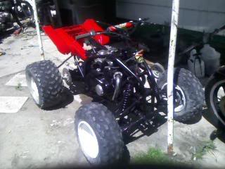

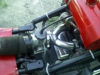

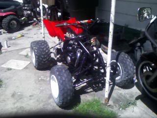

i just finished my build, it is a kawasaki kz400 twin in a blaster frame , i built a custom 1 into 2 manifold with a pj 38mm flatslide to get rid of the crappy dual vm carbs, it is way snappier and has more mid and top end now. i extended the swingarm 3 inches and swapped out the rear shock for a cr500 rear shock to handle the extra weight, and it has adjustable damping and rebound. dont mind the fuel tank it is temporary till i build a aluminum one.
