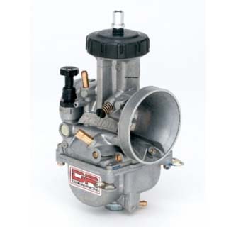

mmajay 800 V Twin Aug 6, 2010 1,636 18 0 65 Busco Beach NC/ Goldsboro Oct 24, 2010 #21 Surfrjag said: but only the 35 and 38 are classafied as airstrikers Click to expand... Airstriker = 4 vents, and the 36 has 4 vents. Not to get off topic but original posted pic looks like airstriker with 4 vents.
mmajay 800 V Twin Aug 6, 2010 1,636 18 0 65 Busco Beach NC/ Goldsboro Oct 24, 2010 #24 BlasterCrazy said: Mine say PWK S65AO LK Click to expand... Thats 35mm airstriker then.

B BlasterCrazy New Member Dec 31, 2008 284 1 0 Michigan Oct 24, 2010 #26 Should I put hose on these nippleshttp://www.blasterforum.com/attachment.php?attachmentid=4191&stc=1&d=1287970905 Attachments Photo 32.jpg 93.7 KB · Views: 85
sheeblast New Member Jul 16, 2010 4,657 47 0 Ohio Oct 24, 2010 #27 you dont have to, i dont even run lines on my vents.
mmajay 800 V Twin Aug 6, 2010 1,636 18 0 65 Busco Beach NC/ Goldsboro Oct 24, 2010 #28 BlasterCrazy said: Should I put hose on these nippleshttp://www.blasterforum.com/attachment.php?attachmentid=4191&stc=1&d=1287970905 Click to expand... Yes,Top 2vents loop up overhead in a crossing manner and lower 2 vents go straight down.
S Surfrjag Member Mar 18, 2010 2,760 34 85 chesapeake, va Oct 24, 2010 #29 i would to keep dirt and mud out
