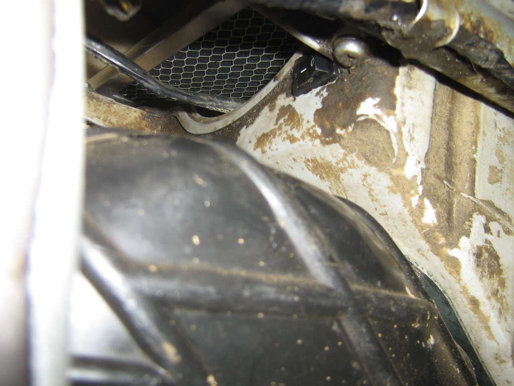

well id like to hook up a toggle switch and put it some were so its hiden that way no thieves can just jump on the bike and go.so where would you put it?
Airbox. All you have to do as far as wiring is ground one side of the switch to the frame and hook the other side of the switch parallel with the orange wire for the coil. That is how the PO had the teather switch hooked up on my 01.
Reactions: Antec1200X
I thought about doing this and using the Head Light switch. I have NOT read into the schematics of the head light but since I dont use mine it would be a great idea. I hate leaving it at the truck when me and the wife both ride her bike or mine as she isnt 'skilled' enough yet to really get down and ride hard and she likes to go 'fast'. Just a thought as no one would notice you switching it off when you got off... in my case I wouldnt want to have someone see me taking the seat off to get to the switch.
I personally would want it under the seat so things don't hit it while you ride. suck to get shutdown in the middle of a hill climb or somethin
there.
